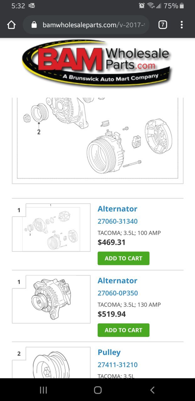

    I believe the Tow Package became Standard Equipment on V6 in 2018. The 130 Amp Alternator was part of that option on my truck in 2017.

    For the 2017, there are 2 alternators according to Bam Wholesale. I have the tow package and I believe I have the 130 amp alternator.

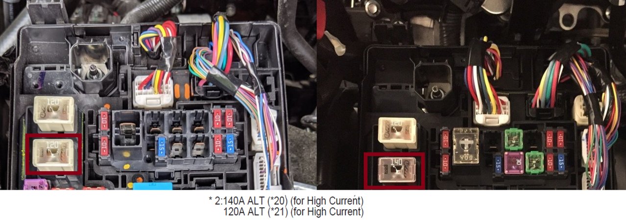

    Yeah mine has a 120jb alt fuse and the 140 alt fuse. Do you just take the average of the two? Sorry I’m not bright at this. Why I’m asking

    So you have a 120 amp fuse at top and a 140 amp fuse on the bottom like the picture to the right. It would seem you have the 130 amp alternator.

    Correct. So you just average the two fuses and that gives you your alt amperage? Thanks

    @caribe makaira is showing the alternator fuse in the fuse box. What the other fuse does I am not sure.

    Ok awesome! Thanks! I was confused seeing 120 that said jbalt and the other saying 140 alt

    Just for future reference, you should never see an electrical circuit protected by 2 fuses. It splits the amperage between the fuses and doesn't properly protect it. Also could cause a problem if working on it and you only remove one fuse with the other fuse still in place.
