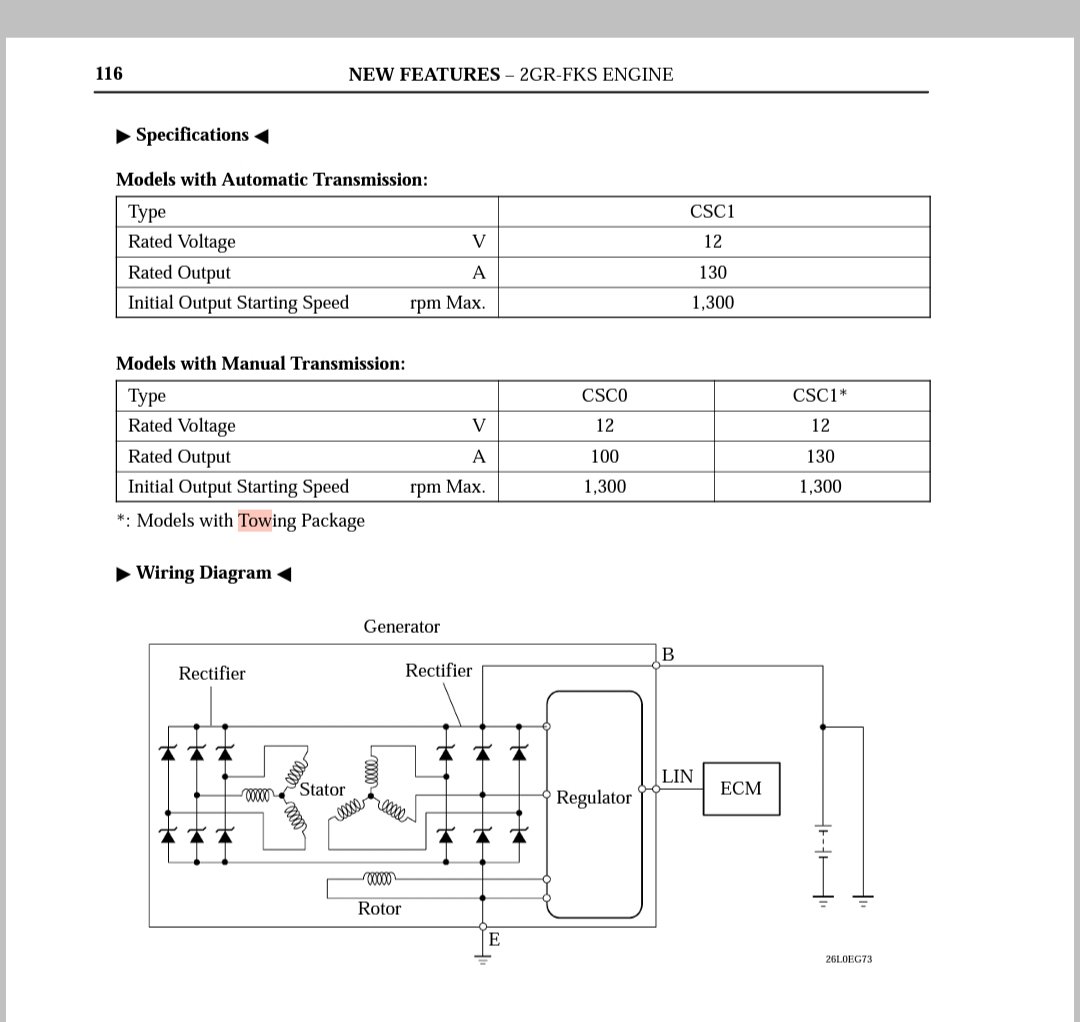

    Here ya go:
    V6 with AT has the 130amp alt
    V6 with MT has the 130amp alt only if equipped with the tow package.

    The Tow Package became Standard Equipment on the V6 Models starting in 2018.
