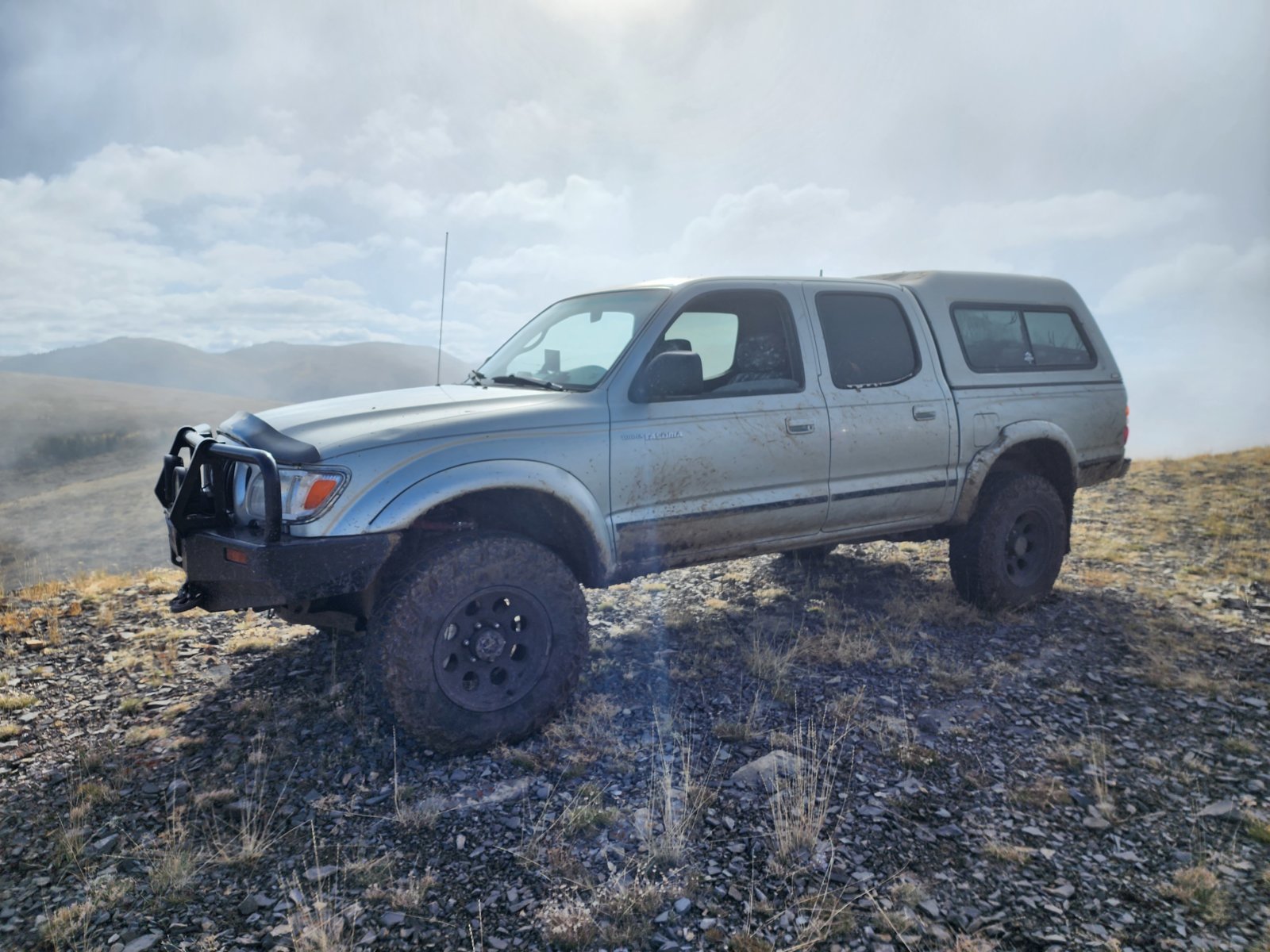

    Alright I have read tons of posts about the same mud tires I have ran now and even in the past. How are you making them last so long? Right now I have 235/85r16 thunderer mt's on my truck. I've read threads that people are getting 40k+ miles out of them? I'm at around 10k right now and have worn off the upper step on the tread so I'm guessing I'll get maybe 25,000 miles out of them which is basically what I've gotten out of all my tires (thunder mt's, master craft mt's, master craft cxt, and duratracs). I rotate my tires every 3k miles and I run around 30 psi to avoid wearing the centers out. So what's the secret to getting that many miles haha???

    Alignment is good and basically everything in the front end is brand new. Brand new upper control arms JBA offroad, moog lower ball joints, inner and outer tie rod ends, new old man emu struts, whiteline lower control arm bushings.
    Truck definitely gets used this is my everyday driver and It's my hunting truck so it doesn't every get a break haha.

    That probably has alot to do with it. I have a shell, ARB bumper, winch, and probably 100lbs of tools all the time.
