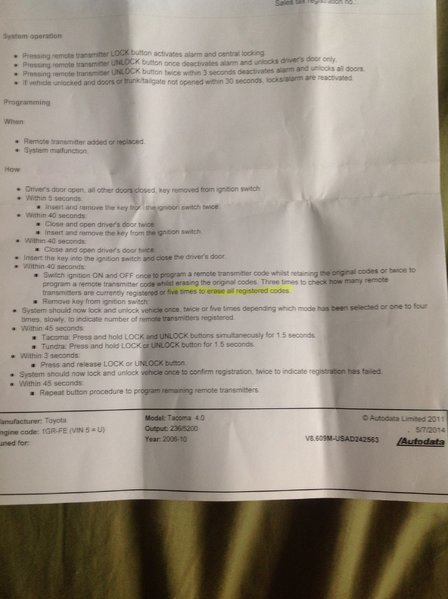

    They have the instructions there, you'll have to go through the process of wiping all remotes from the truck that you don't want it to work on, they give you the instructions on how to do that, as well as how to program them to vehicles @crazytaco559

    i looked all i can find is how to program not how to wipe please point inthe right direction to find those instructions thanks

    Sorry bud, I'll see if I can find the instructions, they've changed their website since I last used them

  13. Feb 26, 2017 at 4:17 PM
    #53
    crazytaco559
    crazytaco559 Member
    Aug 6, 2015
    #161204
    11
    James
    06 tacoma acess cab 2wd 2.7 5 speed
    Thank you i will try this when i get home
