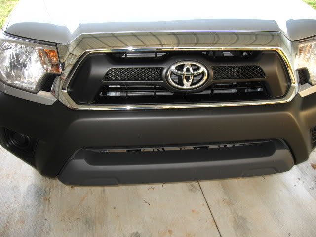

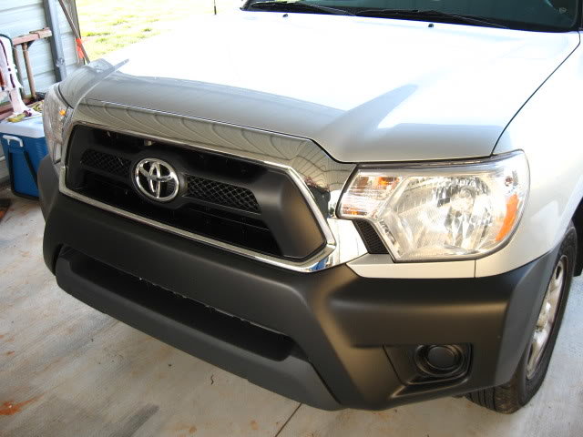

    thanks,i got it out pretty simple once you get it figured out haha
    here is my new grille,going to paint that bumper soon
