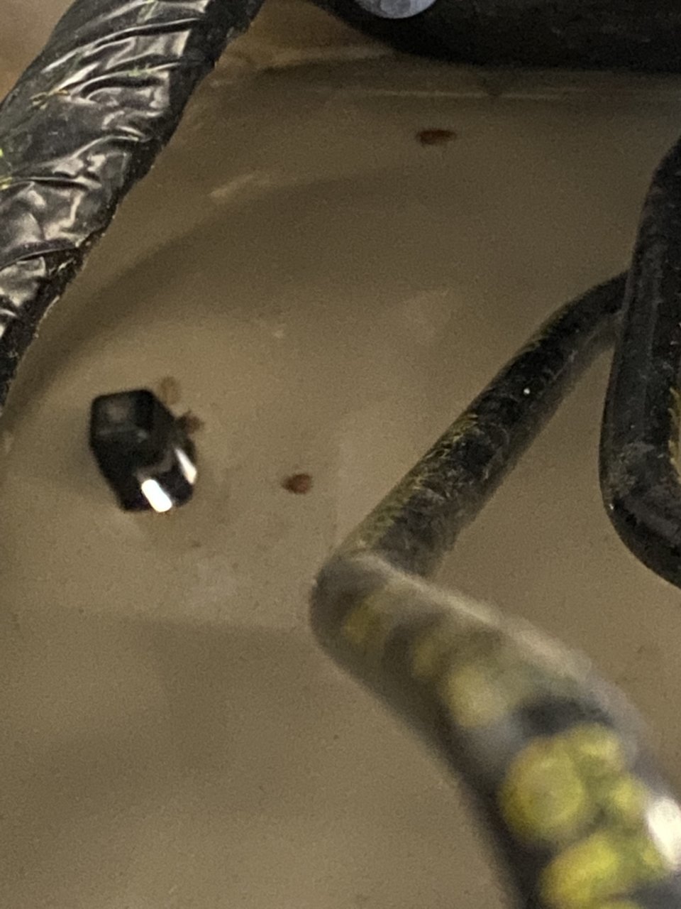

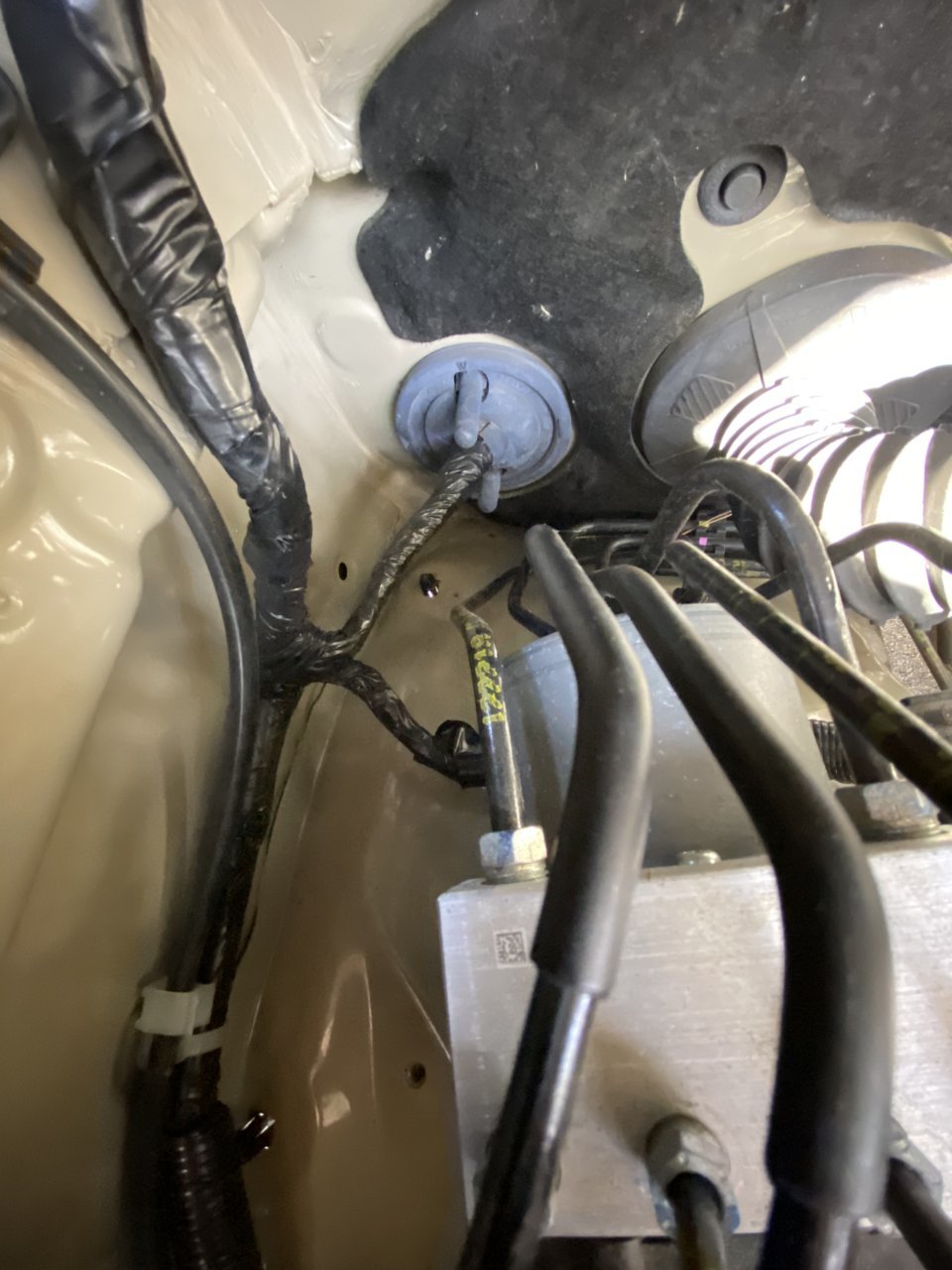

    UPDATE: Upon further investigation I discovered that I can get access to the back of the grommets thru the engine compartment. Now it's just a matter of snipping the backs and the rest of the grommet will fall right out. See pics.
