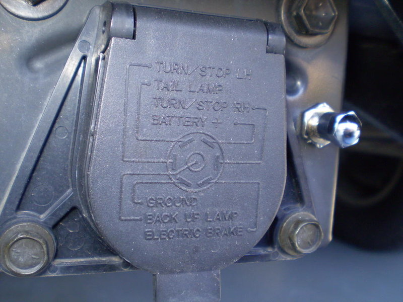

    Put a stainless air hose extension on it and run it out through the electrical tow cable flange....easy sneezy to check and fill air....
