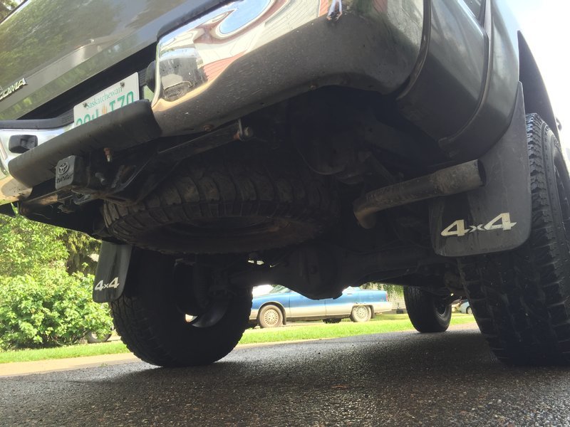

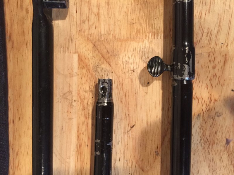

    Same issue today at the tire shop. I wanted to replace my 245/75/16 with an equivalent to 285/70/17 . I used the rods to lower the tire, couldn't see without a flashlight and the rods kept coming apart.
    When I got home I drilled holes in the rods so the thumb screws are more like bolts than thumb tighteners. Rod does come apart unless I want it to.
    Stem down , spare is 285/75/16 $31 tire and installation cdn image.jpgimage.jpg

    For those of you who are wondering why your spare should be stowed with the outside facing up; this protects the valve stem from damage by road (or off-road) debris. If you flip it over and it's that much easier for you to get to it, it is also that much easier for anything (or anybody) else to get to it. I was going to flip mine over and then I thought, "Why tempt fate?" Just a thought for those wishing to be cautious.

    With it flipped you give stowaway animals a nice dry safe place to ride, make a nest & make baby animals.....why would you deny them that?
