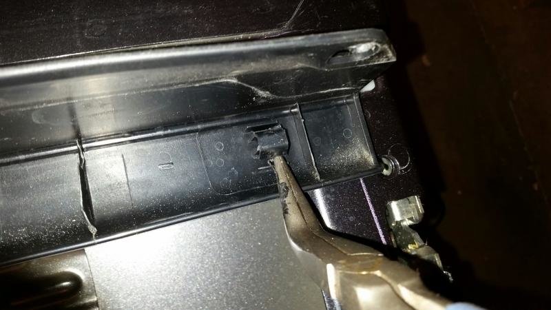

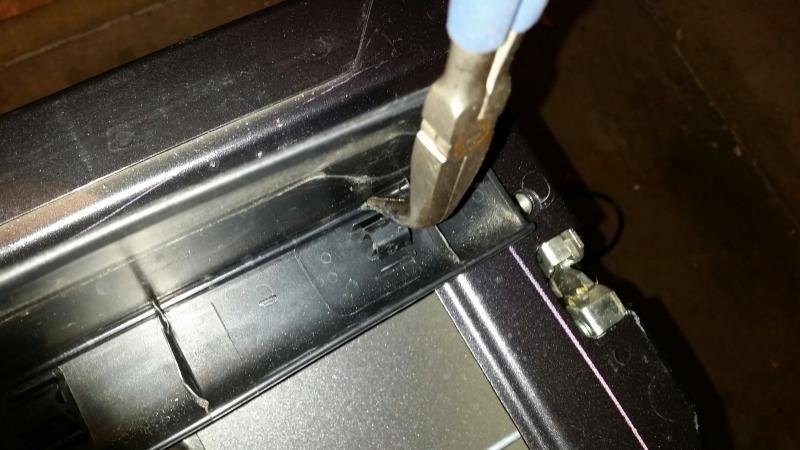

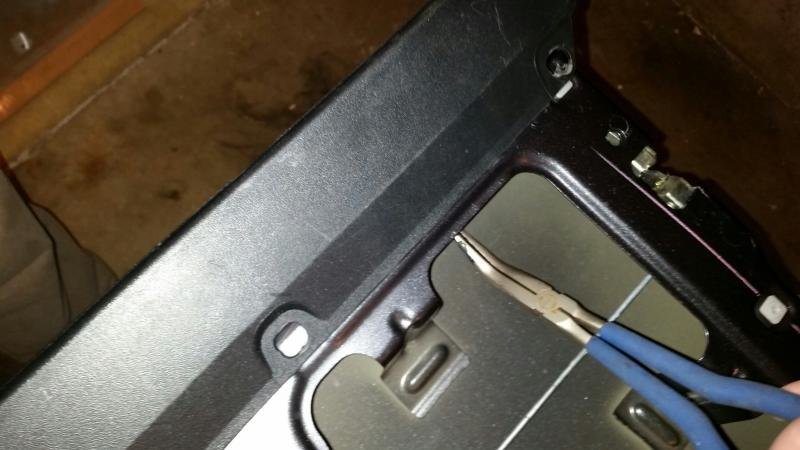

    Ok. For the sake of future Tacoma owners who come here and search for the same thing. I came up with a way to get the cap off without breaking anything. There isn't enough room in there to get a pliers on each plastic tab to squeeze both sides at the same time. I discovered that if I used my large, bent needle-nose pliers
    I could pry on the underside of each tab by using the bend for leverage, while pulling gently on the cap with my other hand
    Then work the top of the tab after the bottom part pops through
    There are 10 total tabs to undo. If you work from one end to the other, you should be able to pull it free with little effort and no breakage.
