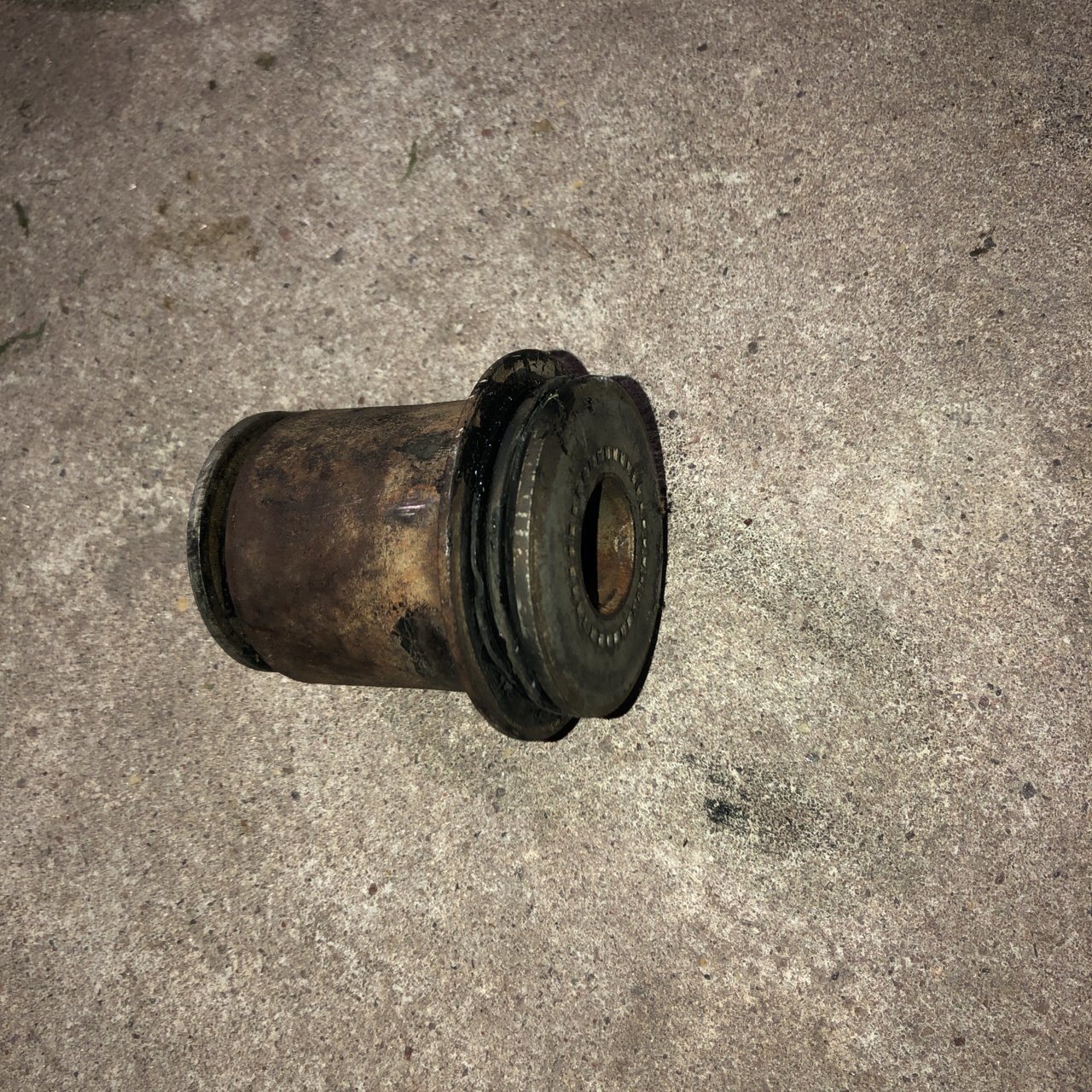

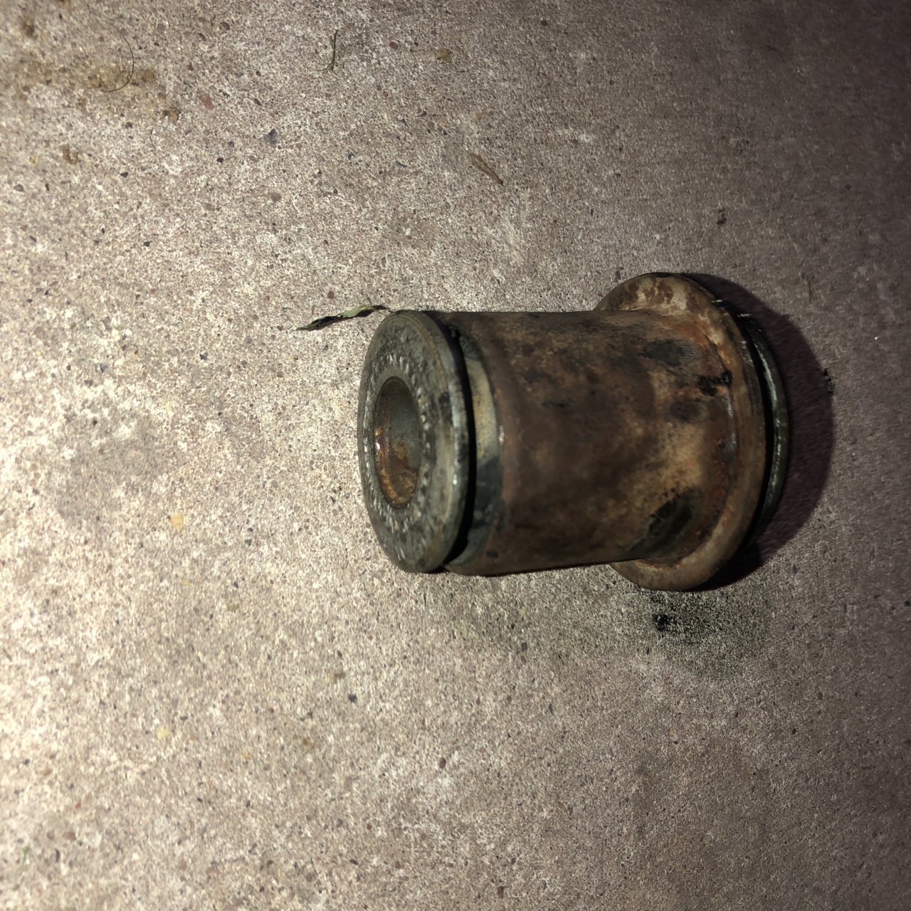

    I managed to get them off of the control arm, but I'm stuck on how to remove this thing. I was planning on using the energy suspension polystyrene bushings. I'm starting to think that it's not worth the hassle of doing it that way and instead just buying the whole new bushing assembly.
    Anyone know of a method to get these disassembled? Would really appreciate the help
    Side note: I've been using this as a guide and also timmy the toolman, but they don't show this step.

    Torch! You burn the rubber out to do the Energy Bushings.

    Some people do that to get the majority of the rubber out. But no matter what, you'll have to use a torch. You have to get ALL the rubber out and get them clean before you put in the Energy bushings.

    I’ve done two sets of the energy suspension bushings now and you’ve got to torch them out! The install guide recommends leaving the outer metal bushing in the control arm for the removal of the old bushing and the install of the new. Those rings on the ends of the center sleeve are a bitch to get out when they’re in the control arm. I imagine they’re very difficult to get out with the entire assembly out of the control arm. Grinding a little bit of material from the face of the metal sleeve helps in getting the ring off. Don’t take too much. Use a large ball bearing, a ball peen hammer, or a socket that flanges out to spread the sleeve back onto the ring when you reassemble. Those rings were the worse part of the whole install. I ended up messing one of the sleeves up on both pickups I did during reassembly. Was able to salvage bother of them.
    From seeing the install process on the Whitelines, I think that’s the route I would go if I did it over again. Especially if you have any corrosion in those middle sleeves.

    I used the torch around the metal shell of the bushing until a lot of smoke started to come out. Though I think the issue here is that the larger washer is really pressed into the metal tube inside of the bushing. Almost like it's welded on to it

    So, let me get this right. The trick is to insert this back into the control arm and then try and remove it from there?
    And when attempting to remove the larger washer (outer one) should I use a ball-joint press (like the method linked) or a pry tool, or other tool you might suggest?

    I’m not saying that you HAVE to insert it back in to get that out, but it may be easier. (It’s gotta go back in anyways if you’re using the energy suspension bushings. I didn’t use the balljoint press. Didn’t know about that method. I followed the instructions provided with the bushing kit and put the control arm in a vise and used a pickle fork to get the rings off.

    It’s a little easier to get those rings off with the pickle fork if you grind a little material away from the lip of the sleeve. Not too much, because it will be reused. The instructions for my 2nd gen said to do that where the instructions for my 1st gen did not and it made life a lot easier.
    I also just used the vise to press those rings back on when it was going back together. Best done with 2 people, but possible to do by yourself.

    He's not trying to get them out of his lower control arm; he's trying to separate the bushing itself from the sleeve.

    Holy smokes y’all. I just swapped. It’s so easy if you just heat the outer washer with a torch till it expands a little. It almost falls off the inner sleeve with a little love with a pickle fork. Actually pulled three of them off with channel locks, just get them cherry hot!!! Work smarter not harder my friends!

    Yeah. I needed the pickle forks to do it that way
