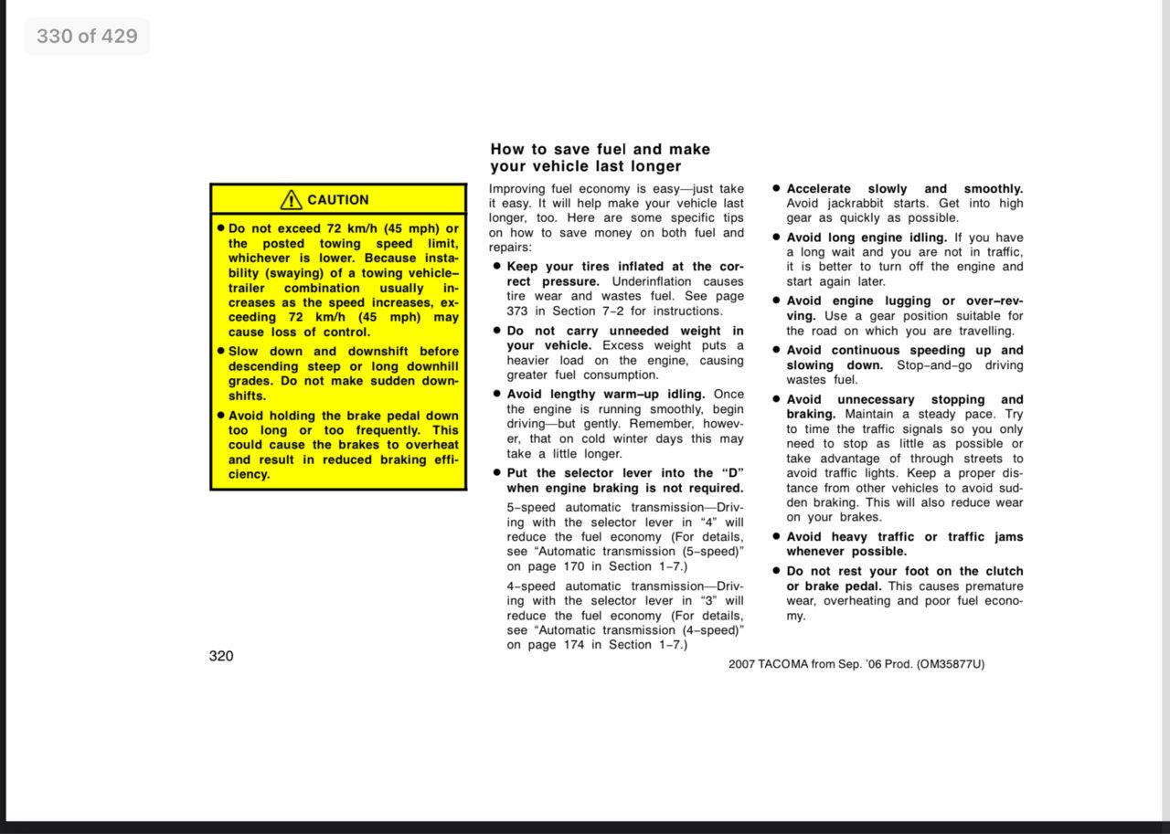

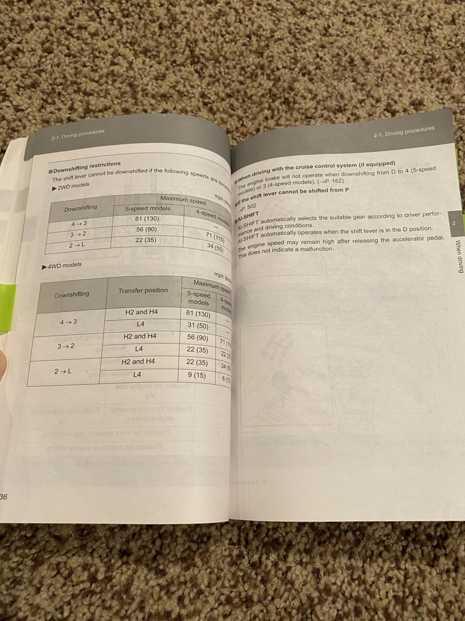

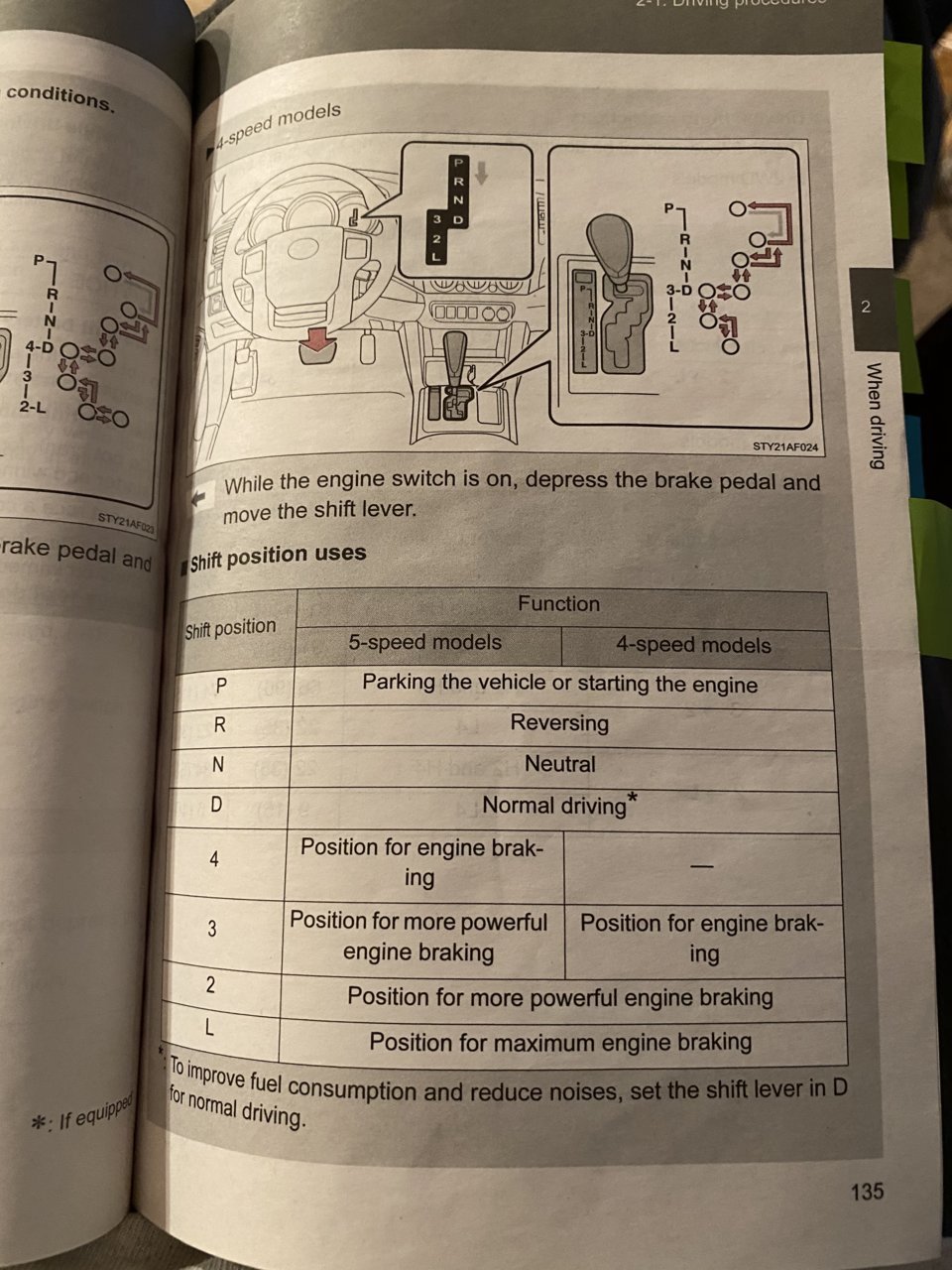

    This is the only material referencing shifting and makes no indication whether applying gas in any way amount may be harmful to a transmission. Needless to say, I have reached out to Toyota for particulars and will report back with what I learn. I would like to see something in writing. :violent:

    @gearcrucncher answered his question.
    The question was
    The best answer is
    As for RPM?
    I’ve shifted mine well into the 3k rpm range under certain circumstances.

    @verynearlypure please do let us know what they say.
    I am going to guess they say,
    “Leave it in 4th while towing”
    “Leave it in 5th (D) under normal driving”
    My manual says not to exceed 45mph while towing?
    And it has a whole section on fuel mileage.
    Im curious to Toyota’s answer.

    Most certainly will do. I hope they are a tad bit more descriptive than that but we all know corporate accountability (or lack there of) sometimes all too well! Gearcruncher’s response was reassuring and if I could get something like that from Toyota I would be delighted.
    The max towing speed recommended for my Tacoma is 65mph per manual. The manual does have some great towing info though.
