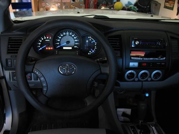

    I want to take some of the dash peices out and paint them black. I know how to get the climate controlls and head unit parts out, but I dont know how to get the parts out with the air vents. Also is there any way to remove the silver bezles around the guages?

    my interior is still stock... the pics isnt of my truck.

    It is actually quite the process. for the gauge bezels, there are two screws under the top lip that come out. for the piece under the climate controls...well that one is a good one. lol you have to take out just about every other piece of trim, center console, piece under the steering wheel, glove box, its all gotta go. but they are all either snap in or snap in with a couple 10mm bolts. not too hard at all.
