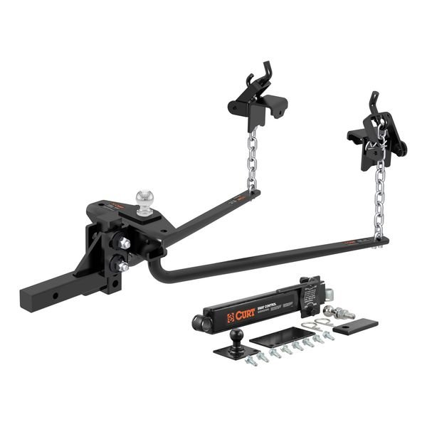

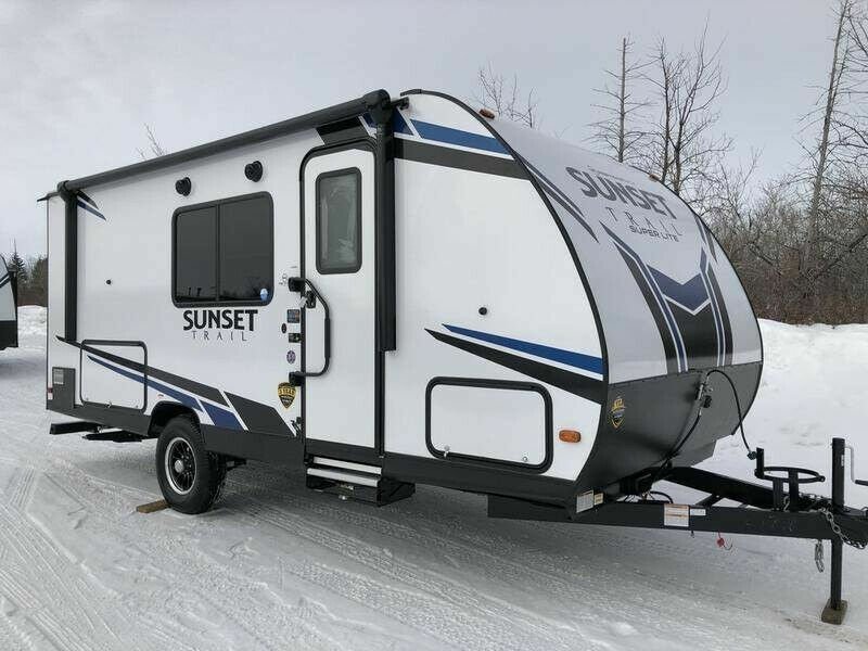

    Taco is a good tow rig IMO when set up proper. ad_1584282606228.jpg ex_q80_w800_h600_images_ePIM_original_CUR17022_3008x1990_a (1).jpg
