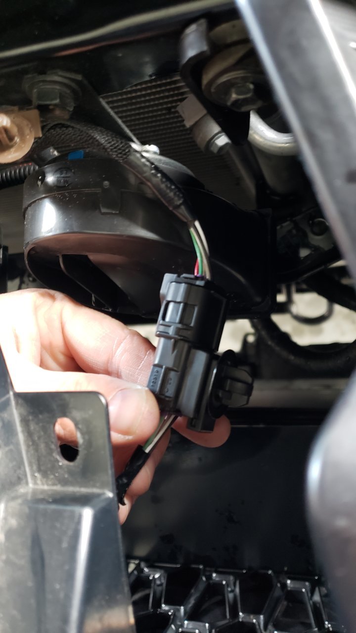

    Taking my front grill off and Ive been trying to unhook this little clip for about 20 mins now. I don't want to break it and afraid to yank on it. Any tips??

    Should be a little tab you need to depress. It may take more force than you think it should.

    There's a button, depress it.

    There's buttons to push on them too.

    Got it, thanks! No on the ridgeline lol

    Push the two clips together first, the push the release button. It'll help alleviate the pressure.

    Perfect, everything went smoothly. Thank you

    Is the radiator mount (top, just right of center, plastic bracket with a rubber bushing & mounting screw) missing a chunk, or is it supposed to look like that?
    I looked at mine earlier this week and it looked like it has a chunk missing. The passenger side bracket is not missing this chunk.
    Yours looks the same, but that doesn't necessarily mean they are supposed to look that way.
