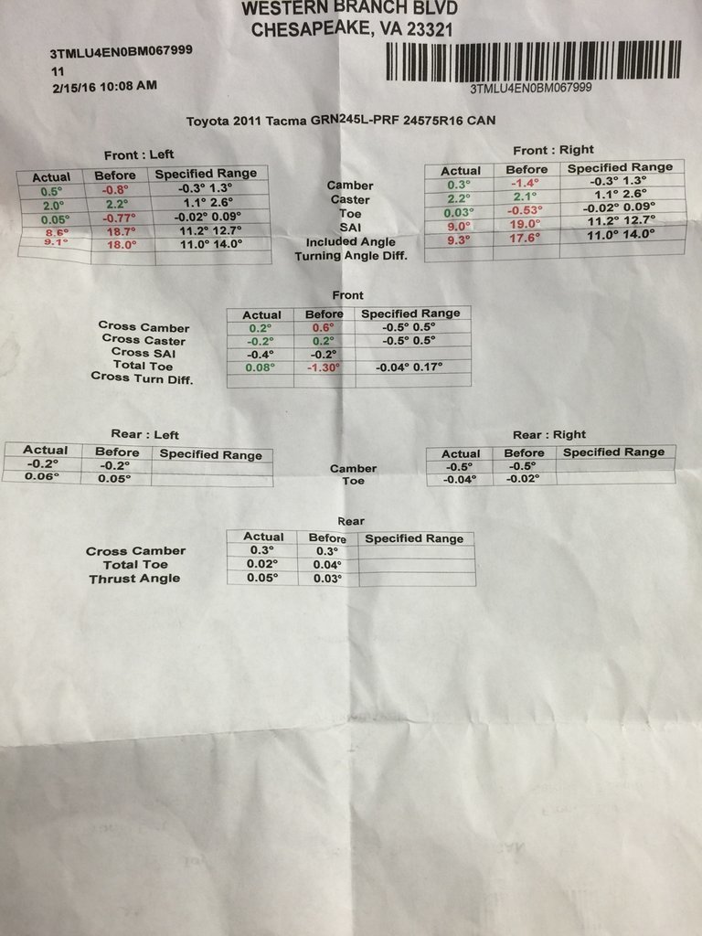

    This alignment is after my 6 inch lift install and 34.5 inch tires. The tech said something about its adjusted the best possible? Toyota dealership couldn't align it due to my tire size so they said, so they sent me to a Chevy dealer. Still has a very slight left pull but I swear it did that stock too, most likely my heavy ass nittos though.

    I'd be very happy with that. Some people like it closer to 3 but that's fine. SAI can't be corrected from what I understand and the Included Angle is your SAI combined with camber. Maybe with a 6 inch lift you have to expect those to be out of stock spec range and focus on the big 3.
    If it's pulling now though, I'd say take it back and get them to figure out why. If they can't get everything in spec they should at least be able to get it so it's balanced left to right. You sure your air pressure is good all around? Maybe your steering wheel is misaligned. Does it actually track / pull left, or does it only do that if you look at the steering wheel and straighten it perfectly.

    Tire pressure is good. And steering wheel might be slightly misaligned to the right by a hair but it's been like that since I bought it. I mean it's a very subtle pull. I will get it checked out again at some point but not honestly worried, it drives damn straight other than the pull/ wandering but I think that comes with the tires. It actually rides better than it ever did stock. Just wanted to make sure the Chevy dealer really knew what they were doing since they claimed to have a high tech laser machine that does the aligning.
