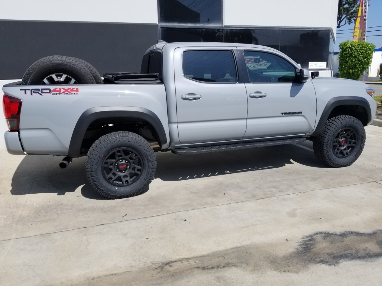

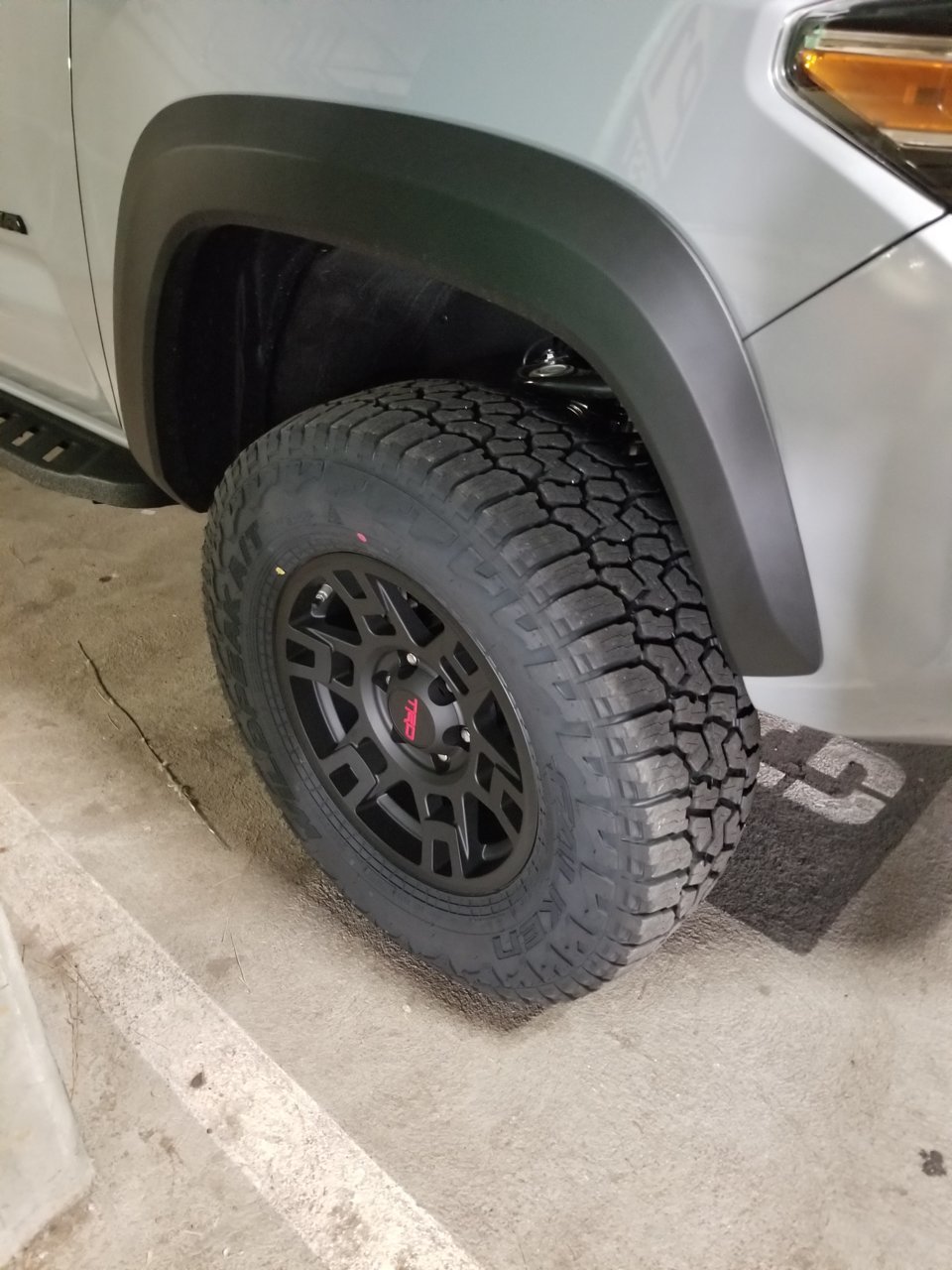

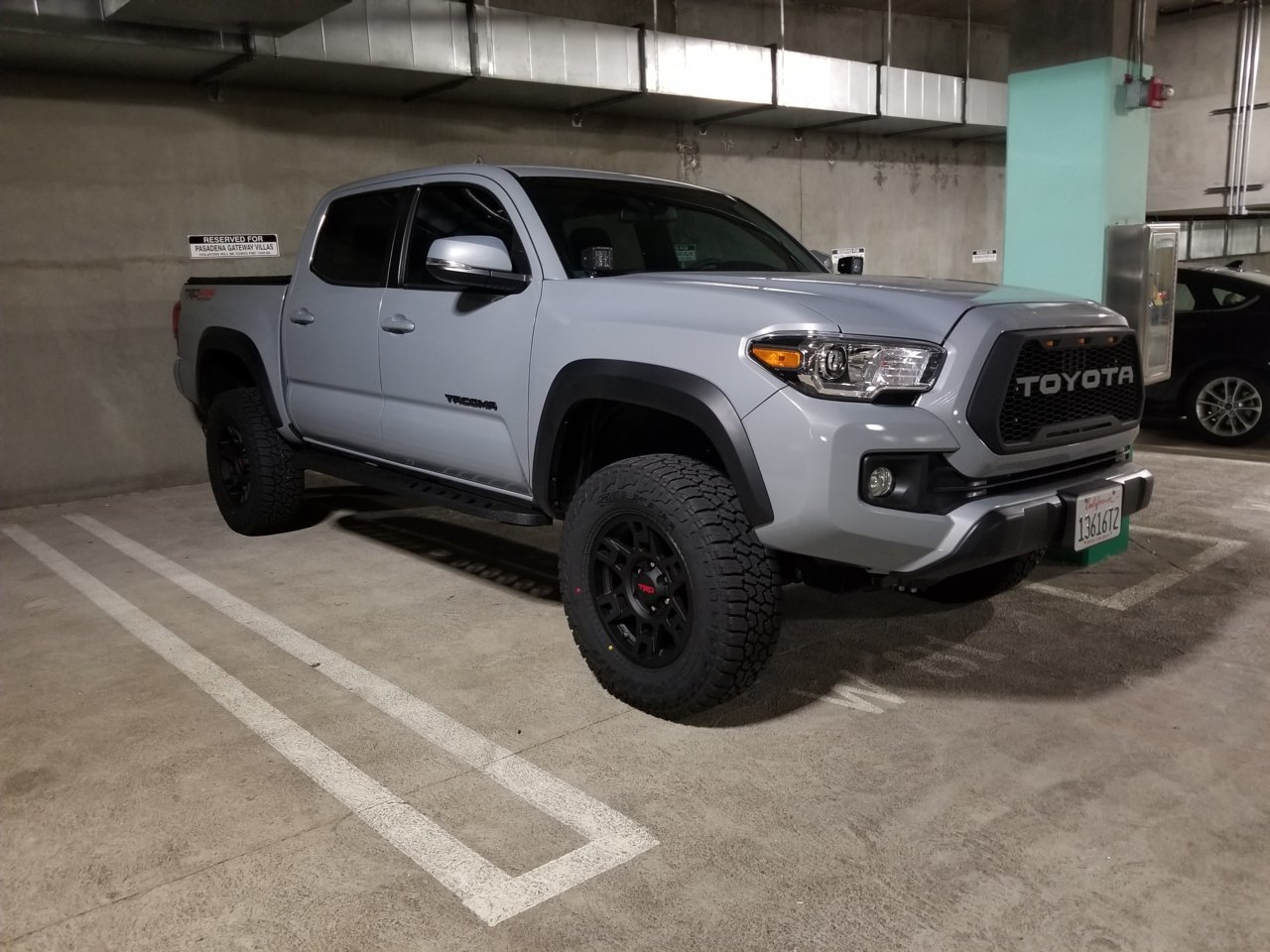

    Thanks for the input everyone, it actually came out just how I wanted. The tires look just right to me and I don't have to deal with any rubbing. I also don't feel a drastic loss in power. The truck rides smooth and is not as harsh as I was expecting from comments. It's a more confiden I'll end up doing the ECGS bushing soon just for piece of mind but that's about it.
    I just hope i don't have any of the sagging issues you guys are mentioning.
    I posted some pics in the "What have you done to your 3rd Gen" thread. Here are some.

    Oh wow it was already in the shop. I was thinking you were still deciding on the setup.
    Looks good. Hope the springs hold up!

    Looks great! Try to report back with similar pics to compare after springs settle in.
