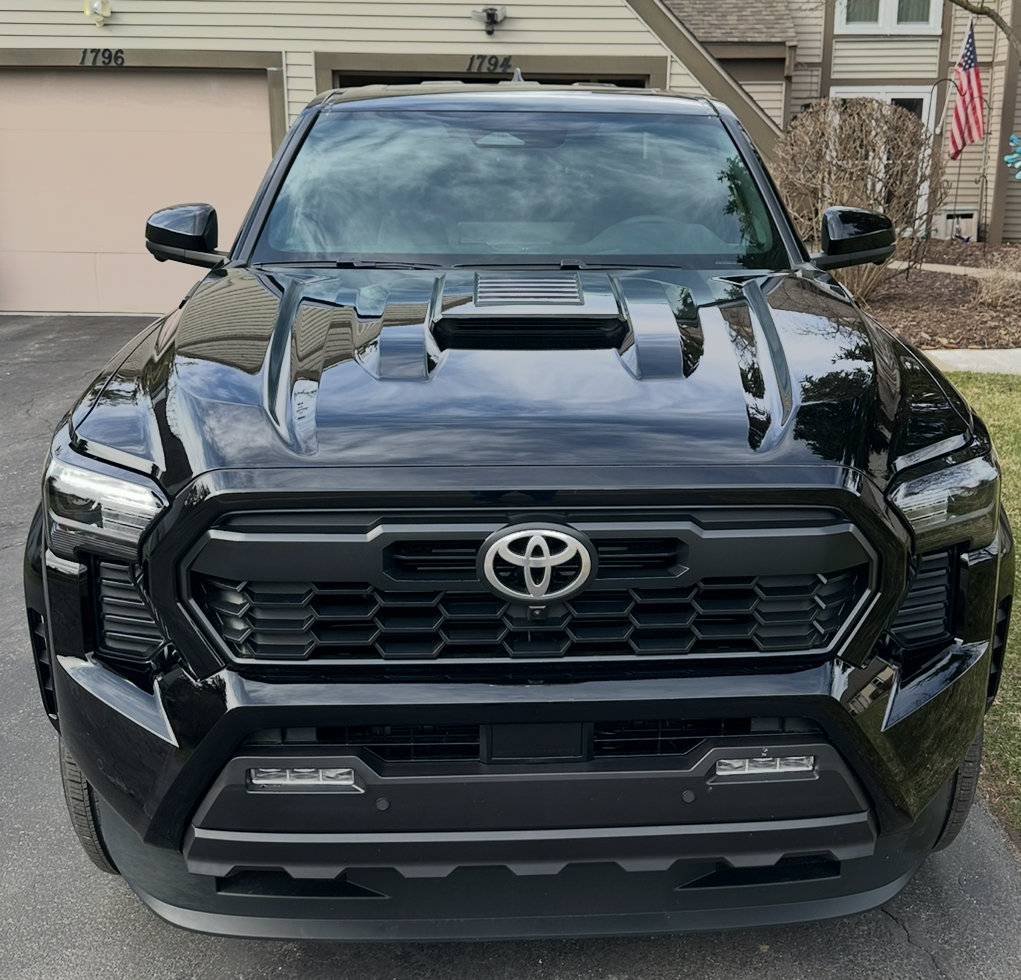

    I’m specifically talking about the one on the grille
    I was going to plasti dip it to complete the black out look, without having to tape anything off or risk getting overspray somewhere

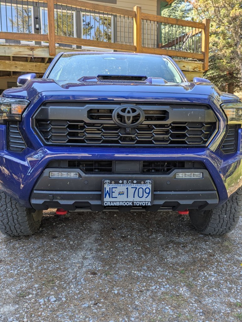

    Open the hood. there 3 tabs, two on either side near the top (plus a guide between them) that can be accessed from inside (it's a tight fit, you may have to use a bike tire lever or something similar) push them toward the centre of the logo. with those two released you can just pop the bottom one out. I did 3 coats of matt black plastidip, very happy with the results.

    Looks great. Is there a reason you went with plasti-dip rather than a high quality matte paint? I was just going to paint it.

    No real reason other than it seems to be what others have done in the past. Also, if I didn't like the outcome I could reverse the results by pealing off the plastidip.
