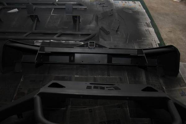

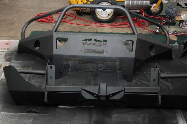

    I am not familiar with how All Pro does it, but we build the reciever right into every bumper. Most manufacturers can't rate the hitch itself, but the way we tie everything together and use only the best materials you can easily see that ours is as strong if not stronger than a stock hitch. The 7 pin connector fits right next to the lic. plate for excellent protection, the hitch is tucked up high and behind where it normally would be.
    we offer two models for your truck, the bushmaster that requires cutting of the sheetmetal, and the trail rider that is a direct bolt on. Pricing can be found here http://www.cbioffroadfab.com/store/page5.html
    Here's a couple pics to show where the 7 pin connector goes.
    Thanks, Steve.

    x2 on CBI. I have their Trail Rider rear and couldn't be happier with it. Here's a closer shot of where the 7 pin goes
    I'm confident with the hitch and use it pretty much daily during the season for my lawn set up and on the weekends I tow my boat. This thing is seriously stout. Just this weekend I got sucked down in some mud and got snatched several times on the rear bumper and of course it didn't budge. You can see my gallery to see how much I was bogged down and to get an idea of how much snatching was required. I don't want to clog this thread up with my pics.
