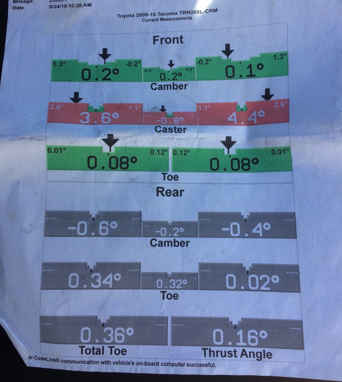

How does this alignment look?

    Right now it's a little toe-out, which I'd be worried about it causing the front tires to get chewed. I have also seen where toe-out causes some wandering issues on the hwy.
    Here's mine. Notice it's toe-in just a little bit. This is so when you start driving forward they go back to zero/center. Think of toe-in as the tires like this from a birds eye view / \
    I also like about half a degree less caster on the drivers side vs the passenger to account for road crown. Camber and caster look pretty good imo, but I'd take it back and have them tweak the toe. Is it driving straight or are you having any issues?

    Cool thanks, it seems like it drives pretty good for the most part, slight wander to the right but not that much. I probably will take it back in and ask if they can adjust the toe a little
