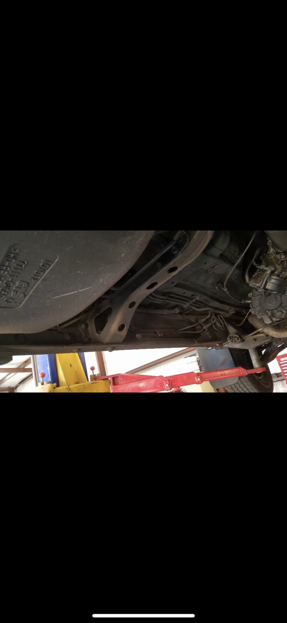

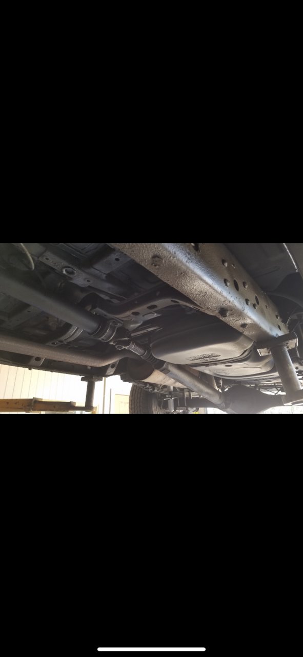

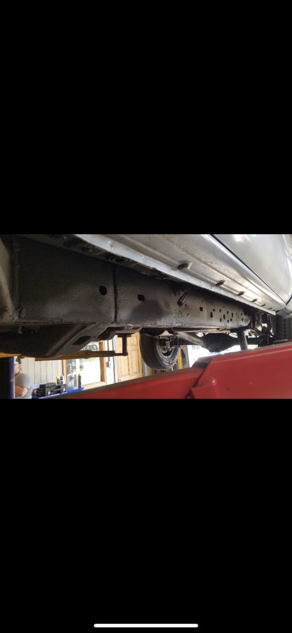

    Found an 09 4x4 nearby. Dealer said its from canada but passed inspection and has been treated. Said does show some surface rust here and there...does this look ok?

    No way to know with out actually crawling under and inspecting it.
    Treated means different things to different people.
    Some call covering up rust, Treatment.
    Sorry man. You really need to go look.

    I’m lucky to live in the South where we don’t have to deal with much rust.
    So, maybe the guys that do, can tell you were to look.
    Above the cats and heat shields seem to be the most common reported here.
    But I’m sure there are other places to look.
    Calling all the Northern guys.......

    Check the frame rails where the layers are sandwiched together... mine had separated.. got me a new frame.

    Check front of frame near front cab mount and cross member, mine had holes, got me a new frame!

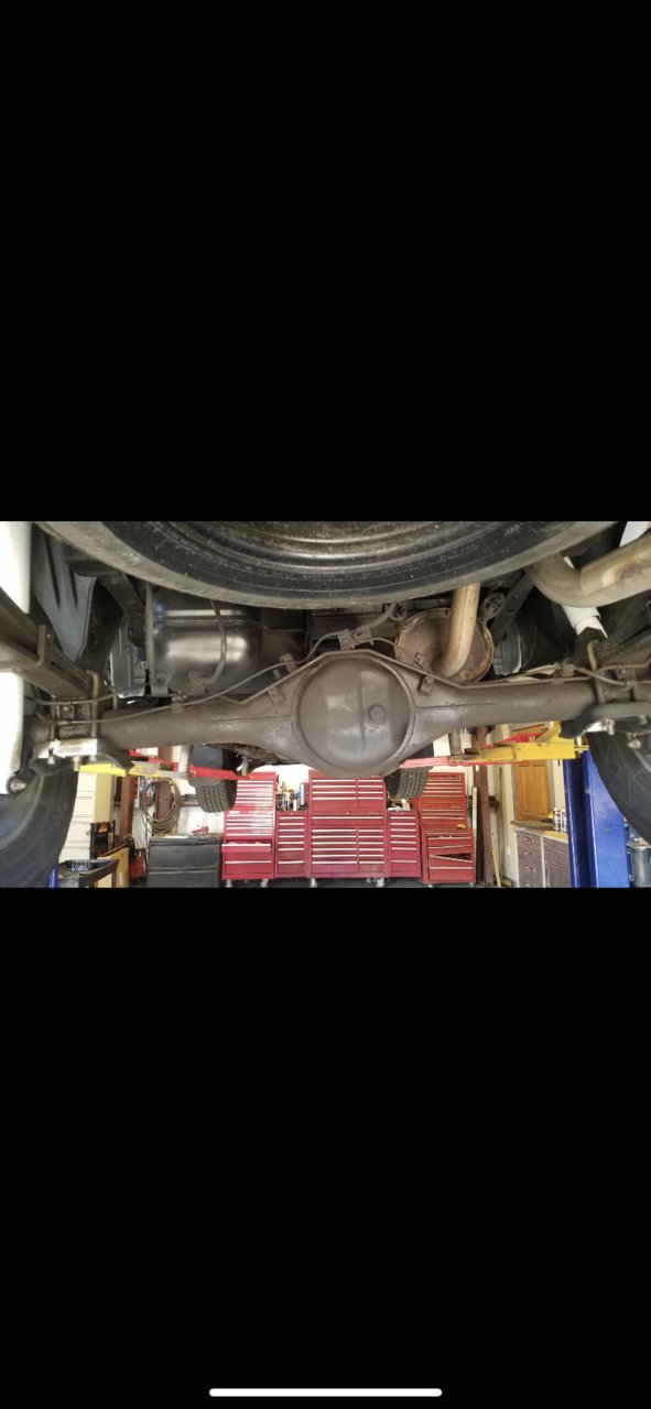

    Those pictures are worthless,you cant see whats under all that coating.

    Check were the guys suggested and take a ice pick - poke around - if that goes thru get it replaced or run.

    Yep, I took a screwdriver and started to scrap and pry, exposing the rot, and I took pics just in case the dealer was difficult, but they were great.

    They more than likely just sprayed over the rust pretty heavy and consider that "treatment".
    Another thing besides the rust on the frame you should consider is seized nuts and bolts that you will run into should you choose to buy it and do your own maintenance. That could be a nightmare in itself and turn a 2 hour job into a weekend long project

    looks decent. make sure to check the frames around the cats. popular spot for rust to break on through to the other side

    Looks rattle canned man...
