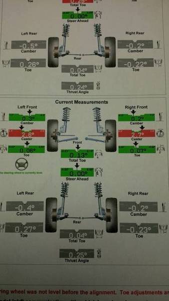

how does this look?

    Come on guys someone has to chime in

    Looks good to me. Hows it drive?

    Drives good

    Yeah, would help if it was right side up. The numbers look like it should steer straight. I'm still not a fan however of such high caster numbers. Do you have a lift kit installed?

    yes 3" front and 1.5 aal

    What do you see wrong with 2.5-3* caster numbers?
