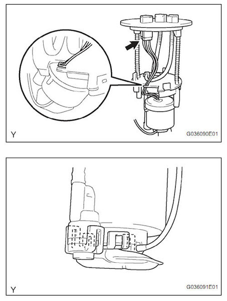

    Urban legend.
    Pump is at top of tank, it is COOLED by gas passing thru it, not by being submerged in fuel.

    No Myth Keeping the pump submerged also ensure that oxygen is kept from the pump in case of an electrical issue. There are many ref to this in the net. A Couple quick finds below - but I can find many more including printed material.
    " and immersing the pump in fuel helps lubricate and cool the pump motor. Driving with the fuel tank less than 1/4 full can shorten pump life by causing it to run hot. It also increases the risk of momentarily starving the pump for fuel when cornering sharply, braking or accelerating. Running out of gas can sometimes damage an electric fuel pump by starving it for cooling and lubrication."
    http://www.aa1car.com/library/fuel_pump.htm
    Warranty issues always subtract from a store’s bottom line. If you have a customer who appears to have more than his share of fuel pump failures, it’s a good bet that he’s running his fuel tank nearly dry before refueling his vehicle - See more at: http://www.knowyourparts.com/technical-articles/fuel-pump-add-ons/#sthash.yqkfh6Ru.dpuf "
    Why Did My Fuel Pump Fail?
    Just how do fuel pumps fail, anyway? One of the most common culprits is heat. Remember in the previous paragraph where we noted that the pump uses gasoline to stay cool while driving? In practical terms, this means that once fuel drops below a certain point in the tank, there is not as much gasoline available to circulate around the pump and keep temperatures low. Frequent driving with an almost empty tank can often lead to premature fuel pump failure.
    http://www.tacomahq.com/643/toyota-tacoma-fuel-pump-replacement-failure/
