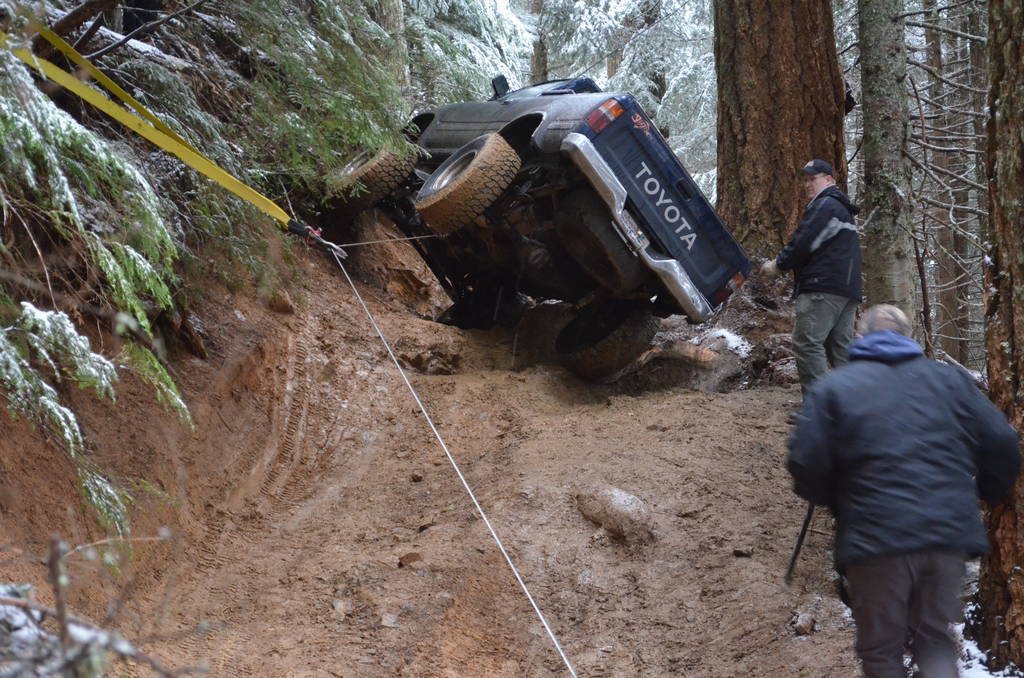

    If you don't draw blood, you're doing it wrong!

    Benson, those pics are so sketchy.

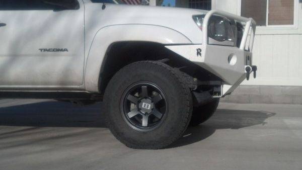

    Because they typically cut away the lower front corner of the bumper.
    Compare to stock:
    Can you visualize why aftermarket bumper has a higher approach angle? (Do you know what approach angle is? Think of it as when driving up a really steep driveway, and your bumper scrapes)
