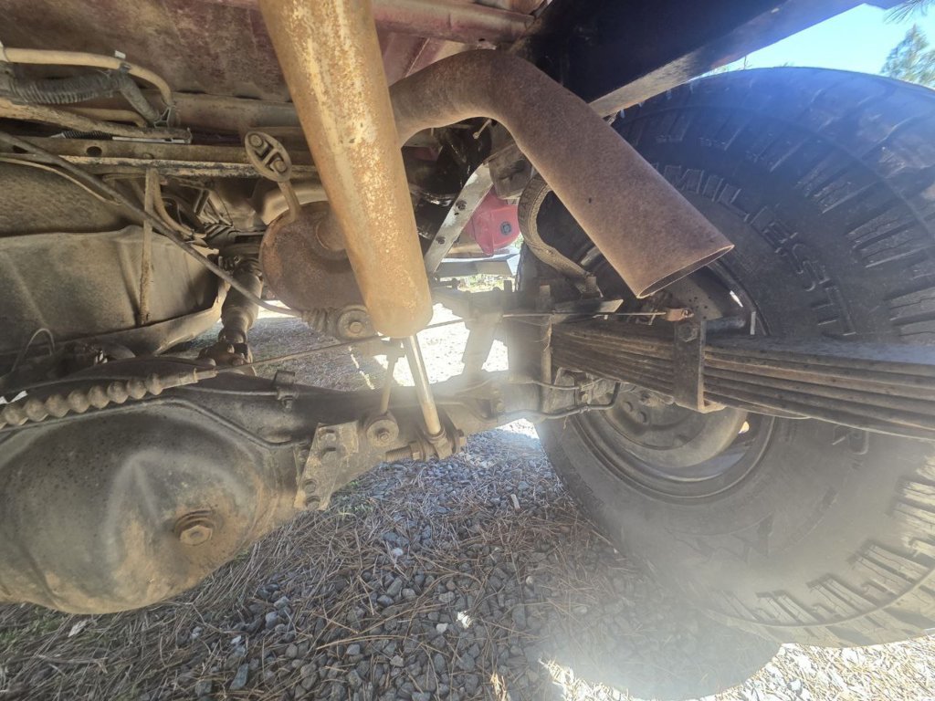

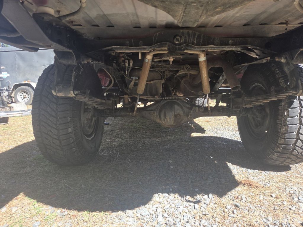

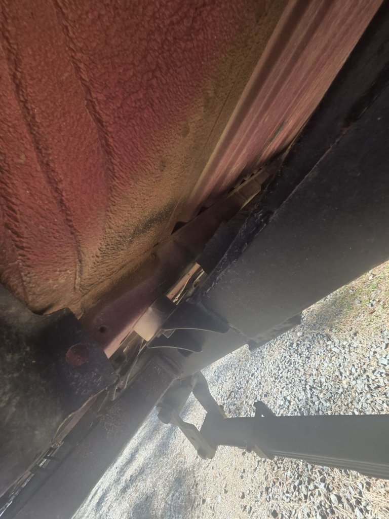

    photo_2025-03-24_16-05-07 (2).jpg photo_2025-03-24_16-05-07.jpg photo_2025-03-24_16-05-06.jpg

    is the last picture a picture of the blocks?

    You have heavy duty shackles
    Heavy duty leaf springs
    And your ubolts are flipped upside down.

    So do you have less lift than you want or more lift than you want?
    You don’t have a block lift - only taller springs and some aftermarket shackles.

    What are ubikts? When i googled them they were just bolts so im not sure if those are the right thing.
    So are the leafs creating the lift right, longer leafs more lift or how does that work?

    The leafs and long shackles are creating the lift.
    "ubikts" is a typo, should be "U-bolts". Stock configuration has the U-bolts point down, and shocks bolted to the U-bolt plate. Your U-bolts have been flipped for more ground clearance, but required new mounts welded to the axle for shocks. That also means your shocks may not be the same measurements as stock shocks, both in length and in bushing eyelet diameters.

    Looks like there is also a 1 inch body lift

    Does anyone know if the rear shocks are actually able to work as intended that close together?
