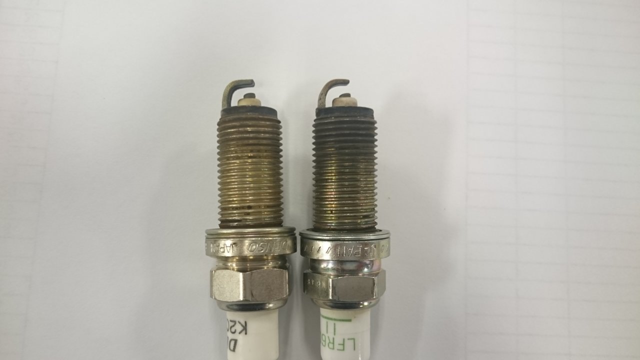

    Wow, can't believe that some are running the copper plugs up to 160k. Here's what mine looked like at 100k. The Denso's (L) were around .048 and the NGK's were around .068. I never really noticed a performance hit with the plugs gap worn as such, but curious to know what kind of life to expect from the coil packs.

    Good pics. Interesting that the comparison showed that much difference.
    I have to say that both plugs look like they were burning clean. I suspect that filing the electrode and regapping would make those plugs work just fine although the life might be substantially less.
