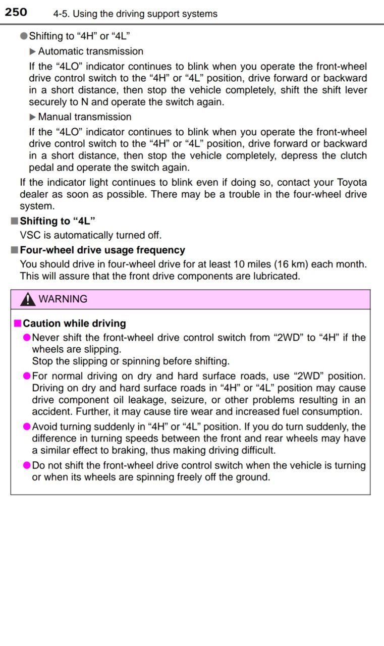

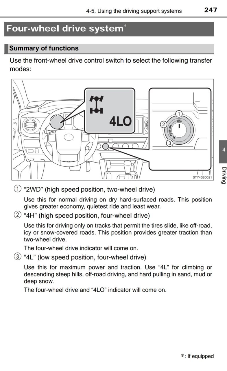

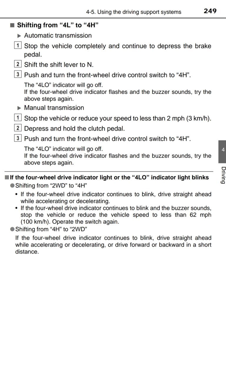

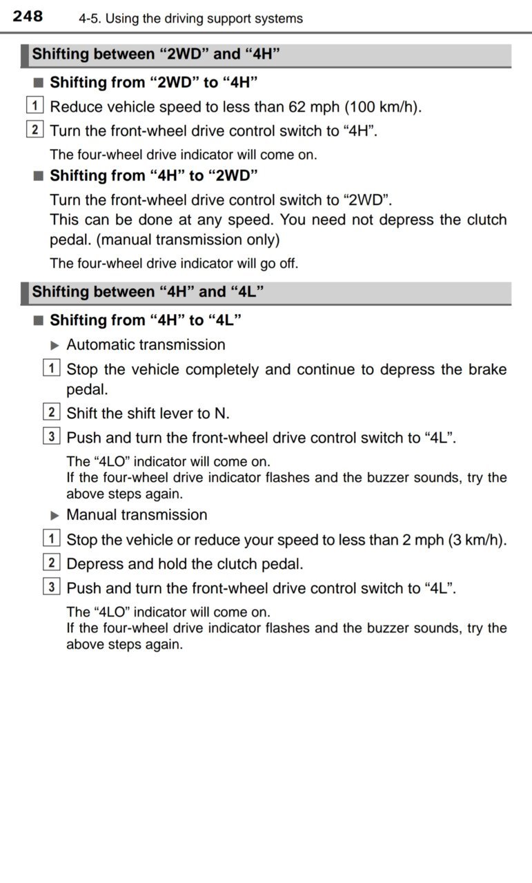

    As per the manual, there is no maximum speed limit on 4Hi operation. There is also no maximum speed limit stated for 4Lo for that matter. The only governing factors being speed limits and or engine rev limits.

    Owners manual states 62mph

    Incorrect, the manual states that speed as the maximum speed at which to engage 4Hi. See page 248 in my post above.

    Ah ok, guess I read it wrong.
