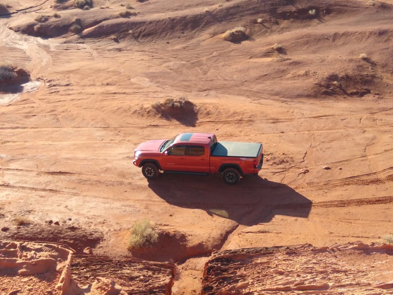

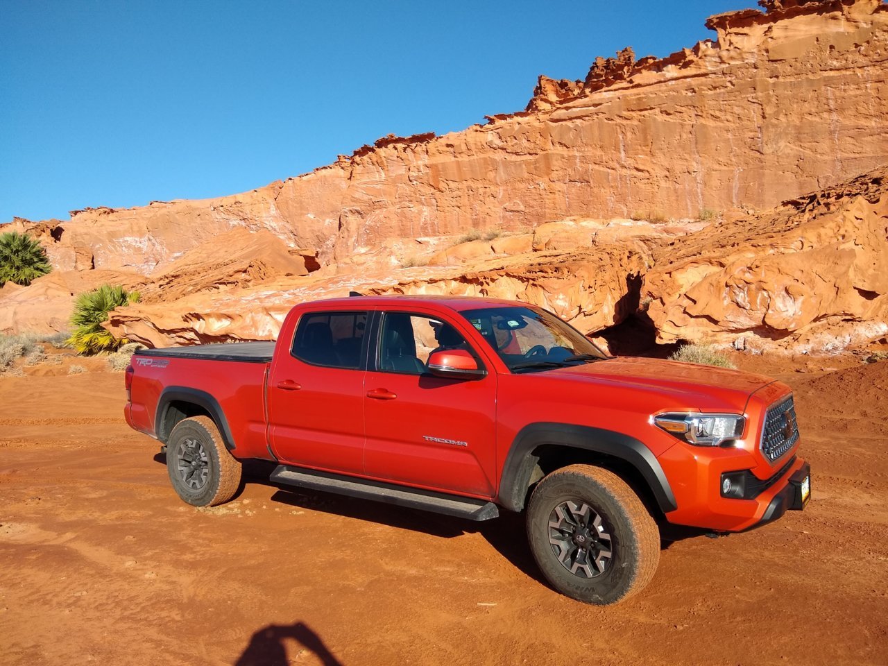

    This is a newby question.
    We drove from Mesquite, NV to Little Finland in Gold Butte National Monument. This is a round trip distance of about 120 miles. About 70 of this was on either badly paved, potholed roads or gravel roads with large gravel; very bumpy. About 20 was in moderate sand and single track on mostly unimproved roads. On the bad pavement and gravel I was going 15-20 MPH. A few other trucks passed me (including a 3rd generation TACO). My question is, if I drove faster in those conditions would I hurt the taco?IMG_20191124_153438825.jpg IMG_20191124_145720670.jpg
    FWIW, I searched for fast and bumpy in the same thread and didn't find an answer.
