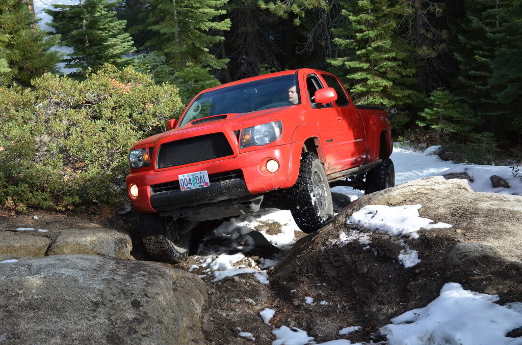

    Heres mine gettin thru some hairy stuff.
    Its crude, but standing on the brakes with the LSD got me through alot of shit.

    Does not compute. You think e-LSD's are a joke, but you are doing the same thing an e-LSD does: braking the spinning wheel.
    To clarify, I'm not saying I would choose an e-LSD over a mechanical LSD, what you said just didn't make sense.

    But the E-LSD doesn't have the mechanical advantage. A friend and I just went up into Tahoe a couple months ago. He has e-LSD, I have regular. I made it through without issue. He required a tow. LSD's do not brake the wheels, there is a mechanical clutch in them. LSD's require torque to work. You get a tire off the ground and they won't work, no traction, no load. Pressing on the brake simulates traction and induces the torque required to lock it up.
    Now, take an e-LSD, which is an open diff controlled by a braking system, no mechanical clutch to control which wheel gets the power. All you're doing is power braking. If I'm wrong, then you should be able to take a completely open diff non-TRD (or any other truck for that matter) and hold the brakes and climb up a hill right? Go try it :)
    I was skeptical about them either way... but when I saw what happened on the trail awhile back, it confirmed my belief.
