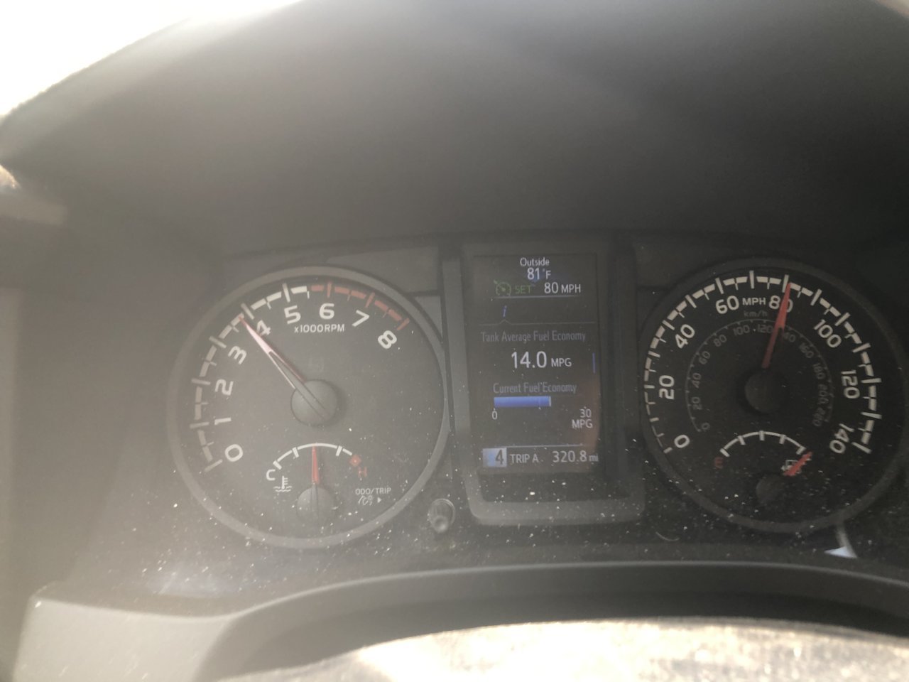

    Pulling a empty 5x10 utility trailer weighs about 800 pounds. Trans can’t make up its mind what gear it wants to be in so I put it in S4 to save it from down shifting 500 times in 1 mile. That fixed that problem but at 80 mph I’m around 3800 rpms. I should also mention that this is the 2.7. Just how hard y’all think that is on the engine?

    I do the same thing headed up the mountain. I see no reason why this would be hard on the engine.

    You really shouldnt do 80 pulling a trailer anyway. Small trailer tires are usually rated for 65 tops.
    How far we talking? 20 mins across town: fine. Extended move / road trip: not great, not terrible.

    You'll be fine. Your MPG will be terrible, but it shouldn't hurt the motor as long as it isn't an everyday occurrence.

    The cooling system doesnt get above 194 on mine even at load. Still I wouldn't go that fast, stick to 65 and it will be safer, and better mpg. I've run 3800 for about an hour and never had an issue, mines a work truck so not sure I care as much as I should. Remember I have the 4 speed so its a little different animal.

    It’s fine. I’ve run 3000+ RPM for hours at a time.

    In the early 90s slick 50 and dura lube infomercials ran 5500 rpm for long amounts of time with no oil. They were so exited!! But in all seriousness the 2.7 is a sewing machine. Its crusing at 3800 rpm. I wouldn't think twice.

    these engines have auxillary oil coolers. it will be fine running at even 5k rpm for hours.

    lol people here who have loaded trucks and big tires easily sit at that rpm on the highway, daily.
    When I had a lifted 3rd gen with 33s, bumpers, topper, tent, all that crap, I easily sat at 3,500 rpm for hundreds of miles when id make long trips. no issues.
