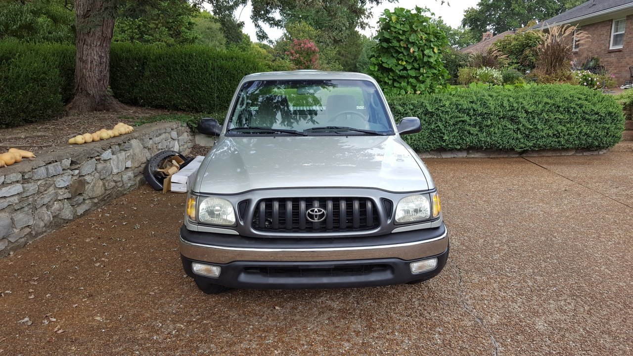

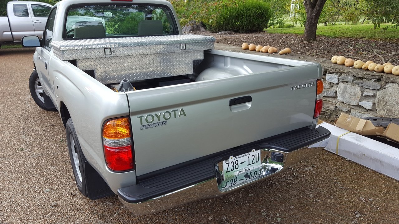

    Well here are some pics of the bumper swap. I plasti-dipped the plastic parts on the front bumper, obviously that chrome part replaced the beat to hell painted part.
    ok7pg6_ef5071a6a112bb421ffe2a74762a85843f4a1cf0.jpg ok7pg6_ef5071a6a112bb421ffe2a74762a85843f4a1cf0.jpg

    I must say this really made a hell of a difference in the truck's appearance, wish I had shot some before shots.
    The front bumper had peeling paint so bad that the primer had come off and it had surface rust. The rear bumper had a dent in the driver's side, rust around where the hitch mounts, a big rusty gash on that thin part where a trailer had hit the bumper, plus it was starting to bubble rust in a couple different spots(the current rear bumper was aftermarket, not OEM Toyota, this truck has been "slightly rear ended" twice in its life, requiring a whole bumper replacement once, then that big dent on the bumper I took off.
    This is a daily driven 182,000 mile Tacoma, but yet it has been looked after and not abused. Interior is just about mint, other than the floor mats, which for being light grey still look decent. Main thing is this truck doesn't have a spec of rust on it, its a Nashville truck. Getting those bumper bolts off was super easy, shit WAS NOT rusted shut. I must also say I reused every single one of the plastic clips on the front bumper and was able to reuse the front turn signals, the plastic part where the screw screwed in was made well enough that it didn't strip out(unlike every single GM plastic part I deal with, if you screw into it twice, it will strip out)

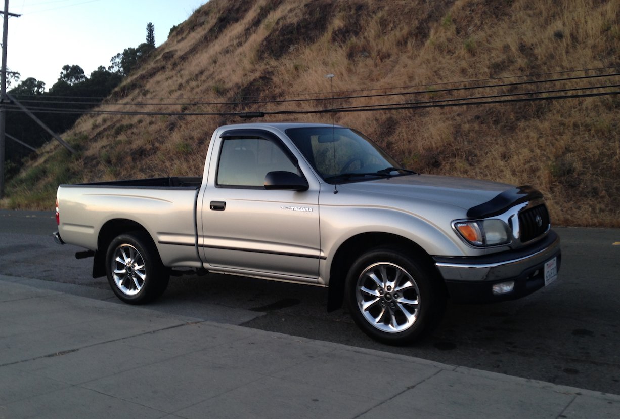

    My truck looked pretty good for being 15 years old but the black bumpers and some of the plastic trim showed its age. I swapped the following parts: chrome bumpers, chrome grill, chrome corner lights, window weather strip, window air visors and mud flaps. Made a huge difference and the truck looks brand new now.

    Man your truck looks NICE!!! I don't know about the bling wheels, as I like the stock styled painted 15" wheels with the chrome lugs. 15" tires do ride nice and wear well.
