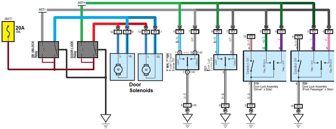

    Using the connectors you already have from the harness do this for the unlock/lock feature:
    If you could get the opposite side of the connectors you could build your own harness to mate with what you have. I show the connector n pin # for the Door switch and Door Lock Assembly. The detection switch inside the lock assembly will not get used. So all lock wires get bundled, same for the unlock. These should be small (18) gauge wires since they are the actuation of the relay coil. For the Door solenoids a higher (16~14) gauge should be used.

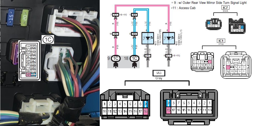

    Door Mirror Turn signal:
    IA3 connector is behind the Driver's kick panel next to the Parking Brake. More hidden tap location for the Mirror Turn Signals.

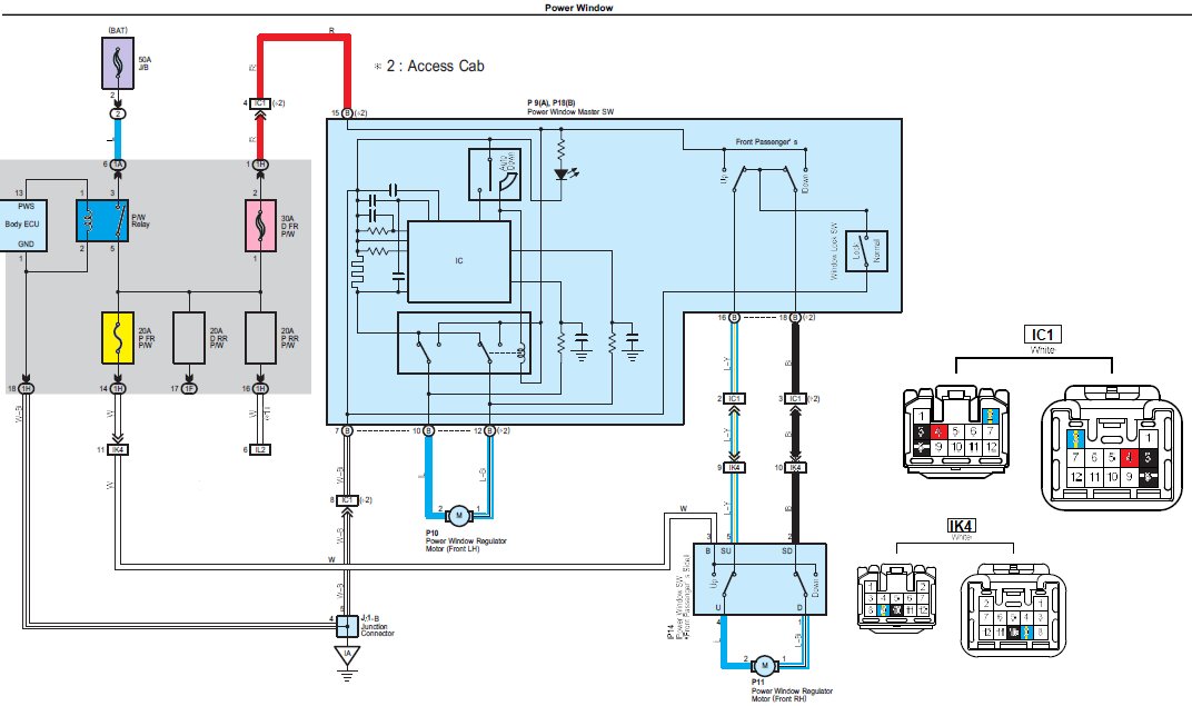

    Power Windows:
    If you are missing the Power Window Relay it's easy to install. That way the 17 pin on 1F connector of the cab fuse box would get energized (fuse added of course)
    Connector 1H is behind the fuses. Adding the missing wires is also not that difficult. That connector also uses terminals 090/2.33 type (females).
