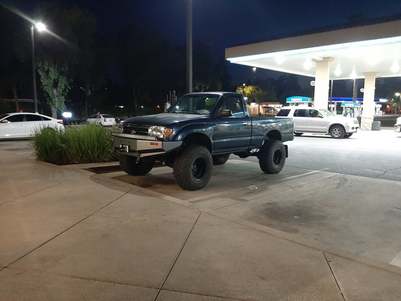

    I have the toyotech 620 with 5100s set at the lowest setting. I also have most of an ARB bumper and a winch. The ride is absolutely perfect, not bumpy. I couldn't be happier. Last weekend I put about 20miles of fire roads + some medium rock crawling. And the ride was very good.
    Here is how much lift I got, I don't know much much you will gain over stock, because I had a spacer lift before. Now it's at about 39.5? At the fender arch.
