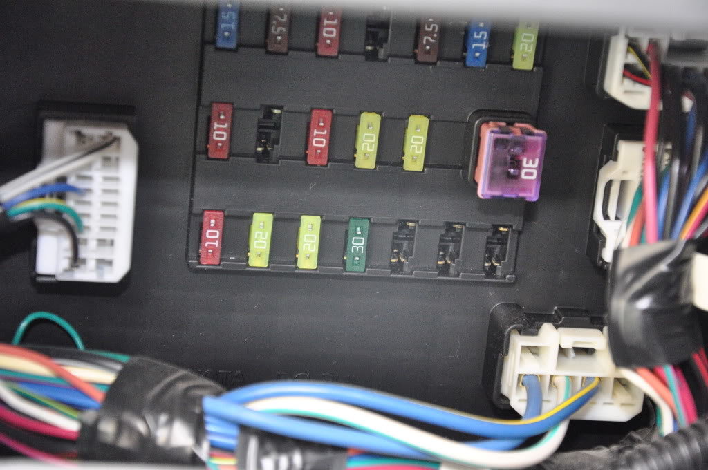

    im trying to decide if i should hook it up to the dome light or a switch in the factory blanks. is there any places i could splice into that turn on when the headlights r on by the dash of a 08 base stick ?

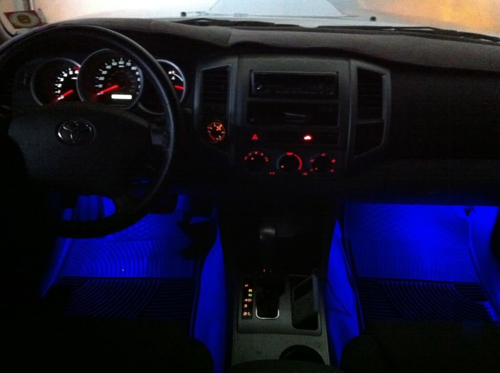

    I got 2 prewired leds from oznium.com and put one in each corner under the dash. Not to bright at night, so they aren't distracting. I tied them into the shifter light, but you can tie them into the a/c control light. Its very hard to capture the true output with the camera. Here's a link to them http://www.oznium.com/prewired-surface-mount-led

    wait a minute... is it the camera or are your gauge lights NOT amber? don't presume so, because i see amber color on your control panel.
    i hate my amber gauges.
    :confused: HUH? :confused:

    This is a great idea.... happen to have a write up?

    I'de like to have explained whats on your dash hey?

    I changed them to white shortly after I got the truck. I never liked the amber look.
    Edit: that's a dash mat on top if that's what your asking about

    heres my fues box. also i will do a write up if anyone's intrested
