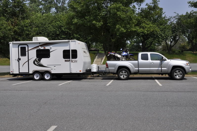

    Once you start to conciser the WD system the TW (tongue weight) pretty much goes out the window but you should try to stay close to your trucks max TW. The hitch on the tacoma 4.0V6 is a class 4 hitch. If it was on a bigger truck it could be rated up to 10.000lbs with a TW of 1000lbs. Because of the Tocos lighter weight and smaller drive-train it is rated at TW 650 and a trailer weight of 6500. These numbers are for a single ball mount TW with the MAX Trailer weight. Once you put the WD hitch on it is a matter of equalizing your TV (tow vehicle) and trailer using the WD system and making sure you have a strong enough system to handle the weight you are trying to distribute. You should never go over the max trailer weight rating or truck cargo rating though. ANything, cargo or weight added aft of the rear axle is considered as part of the TW. This is why you adjust a WD hitch with your TV and trailer loaded. When my rig is loaded with bike in the truck and full tank of water with full LP tanks an two Batts. I have to really crank the WD system to get it level but it works fine and my truck handles great. I have never had any white knuckle driving with my rig.
    Using air bags is for a single ball mount with out WD or a heavy cargo load, to raise the rear of the truck. It does nothing to distribute weight it is all still on the hitch or bed and the front will still be light.. If you have airbags and a WD system you should set the bags at the normal setting then adjust you WD system leaving the bags alone. You should not use both of them together.
    As with any towing you must use common sense and think about you, your family and everyone else on the roads safety as you haul. I think my rig is very solid and I do not drive fast, 65mph max. I have dragged this trailer to nothern Maine from Maryland and as far south as myrtle beach, SC with no issues. I do not haul the bike on the long hauls.
    Here is a link on hitched
    http://www.etrailer.com/faq-weightdistribution.aspx
    Here is a link on how to measure TW
    http://hildstrom.com/projects/tonguescale/index.html
    A pic of my rig completely loaded. GCVW 10,552 lbs on certified scale.THe TV rear wheels had 175lbs more weight than the front due to the WD system and I had 3/4" of rise on the front and 1 1/2" of sag on the rear.

    Man, that TV of yours looks like mine, but you have the dual axle on your trailer.
    I *think* that helps on the tongue weight, as opposed to my single axle trailer. From your pic it looks like I had the Equalizer WDH setup the same way as you, but my rear end sagged more.
    And I don't see what you have for rear suspension. In any case (and I realize a lot of towers aren't interested in this) but the WDH in my limited experience does not do well offroad, even mild offroad. It gets torqued around too much, the trailer side hookups move back and forth and loosen up, the L-bars get bent. Just food for thought . . . . .
