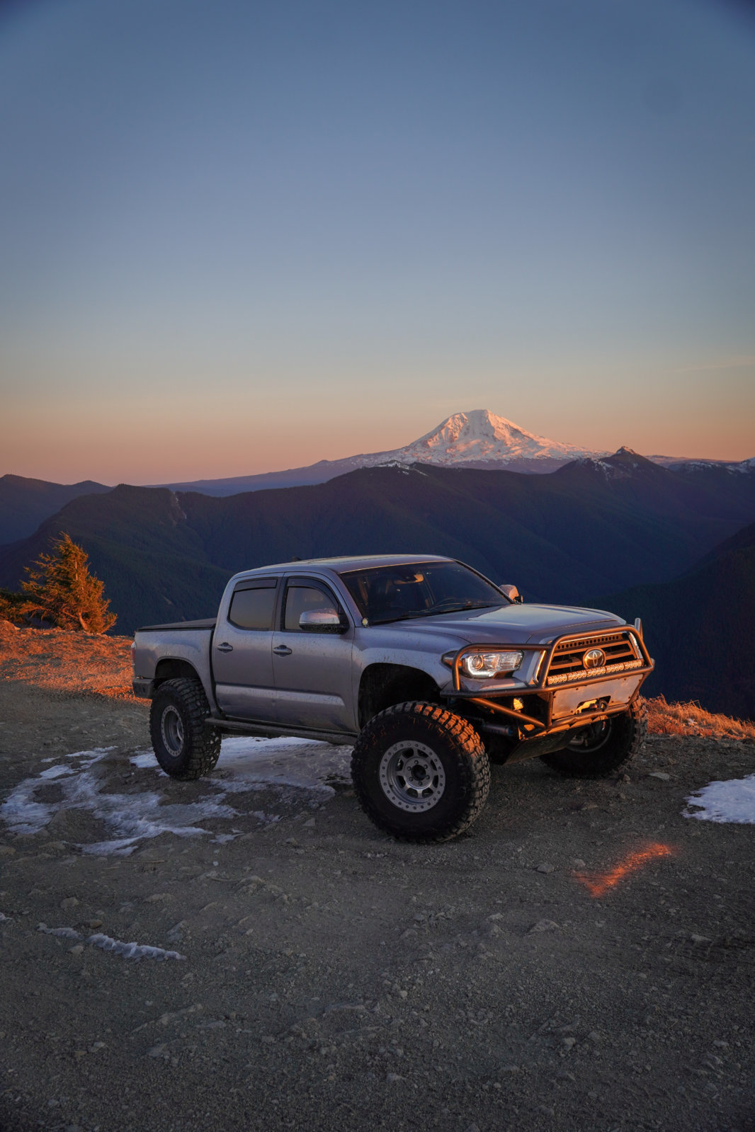

    Average about 5900lbs, 37s, 3 link, whole lotta metal welded on, box full of tools and full size spare

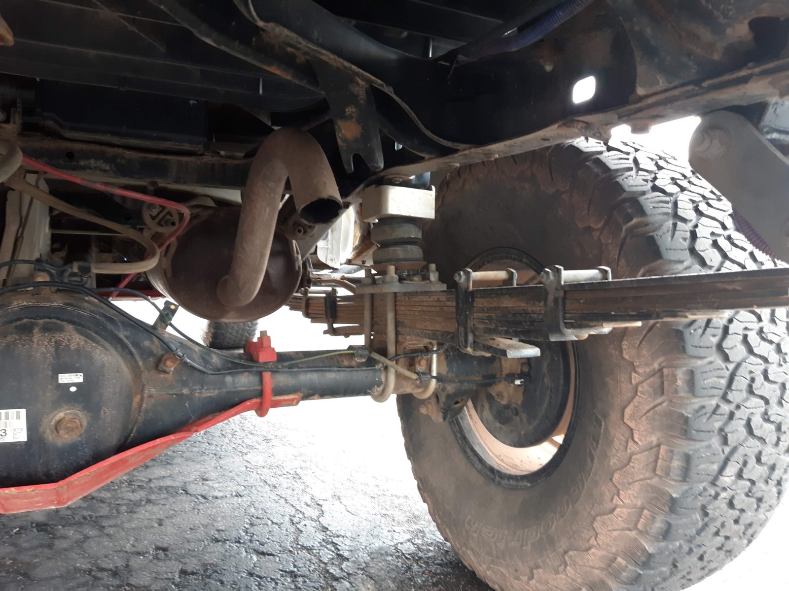

    You need more fancy suspension stuff and the willingness to cut metal off of your frame, but it's an upgrade worth making IMO.
    [​IMG]Rear Towers plus Misc. by Michael Rickerd, on Flickr

    (2) thru bolts with a plate on top. Top of the towers is on the underside of the wheel well.
    Grey plate in photo below:
    [​IMG]House Battery Upgrade by Michael Rickerd, on Flickr
