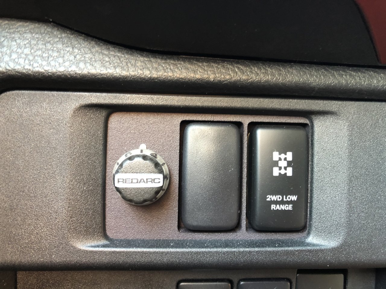

  9. Jul 19, 2020 at 3:58 PM
    RushT
    RushT Amateur Everythingist
    Dec 10, 2017
    #238171
    5,650
    North Texas
    '18 DCSB TRDOR Inferno
    Really happy with my RedArc Elite. Super clean install in the driver's side cubby. There's a good chance however that a pop up style camper doesn't have electric brakes.

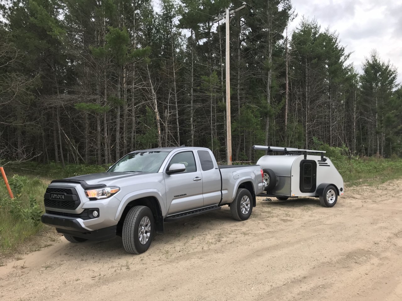

  13. Jul 19, 2020 at 5:43 PM
    usmc2msu
    usmc2msu Well-Known Member
    Apr 10, 2020
    #324315
    650
    TJ
    2017 SR5
    I pull a teardrop that weights close to what a lot of popups weight. I’m around 3k when fully loaded with camping gear/people/etc. My 2017 SR5 pulls it like a champ and I average 17 mpg in northern Michigan. No electric brakes and no need for a WDH. I don’t think any popup will pose an issue for you.
    TroutBum and Taco_mike73 like this.

  15. Jul 19, 2020 at 6:01 PM
    t0nyvalenzuela
    t0nyvalenzuela Well-Known Member
    Dec 1, 2018
    #274466
    363
    2019 Tacoma TRD OR DCLB
    Puck level
    Dude. Pics!!
  16. Jul 19, 2020 at 6:01 PM
    #16
    Taco_mike73
    Taco_mike73 Well-Known Member
    Nov 22, 2019
    #311413
    3,165
    York, PA
    2020 Cement SR5 DCSB 4x4
    Lomax tonneau cover, oem bed lights, AJT Design chrome delete, black out badges & tailgate letters, AVS hood deflector & vent visors, Solkie tech hood supports, interior LED lights, Tufskinz mud guards, RedArc TowPro Liberty, bed mat, kicker speaker upgrade, Hikari ultra H11 low beams, Diode Dynamics SS3 fogs in yellow, Meso customs total taillight stage 1. Coming soon: Compact powered sub install Future mods planned: bigger tires (265/75/16) BILLSTIEN 5100 lift
    That's a cool little camper.
  17. Jul 19, 2020 at 6:02 PM
    #17
    RushT
    Dec 10, 2017
    #238171
    5,650
    North Texas
    Here you go.

  19. Jul 19, 2020 at 6:05 PM
    #19
    RushT
    Dec 10, 2017
    #238171
    5,650
    North Texas
    There's a small Toyota button blank that'll hold the redarc knob... it can be found e-trailer.com, there's also a full cubby replacement on thingiverse, which is what I have.
