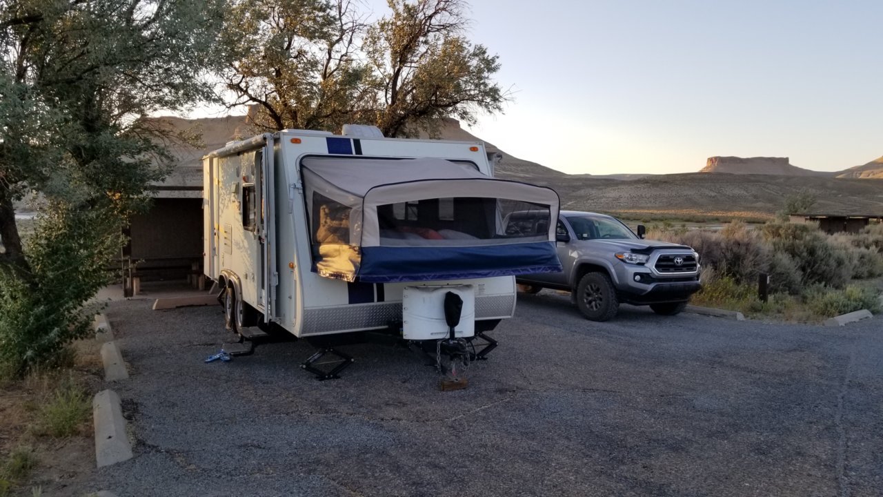

    Your truck can pull that just fine. I got back today (TN) from a 5100 mile trip out west to Wyoming, Montana, etc. Went over/through the Rockies pulling around 6000 pounds with my hybrid travel trailer (4700 pounds dry weight). I have a weight-distributing hitch and a trailer brake controller. Mileage sucked (averaged around 8 mpg while towing), but was better in the mountains (around 10) than flat lands (7 to 8) because it stayed in 3rd gear on the flats (and on mild uphills) due to wind resistance, but could downshift on downhill grades. If I could haul the trailer, family, and assorted gear in the bed across the country, what you're describing will be a piece of cake. Yes, it would have been more comfortable in a larger truck, including lower RPMs and thus quieter, but it did its job admirably well.20200714_202354.jpg

    What did you use regarding the transmission. ECT mode on? S gear limiting higher gears? I have almost the exact set up you have, a Keystone Cabana hybrid. I have the brake controller installed but will not be using a weight-distributing hitch. I only towed it twice so far and just used ECT mode on. Even with that the RPM's were high during accelerating and got about 15 mpg.

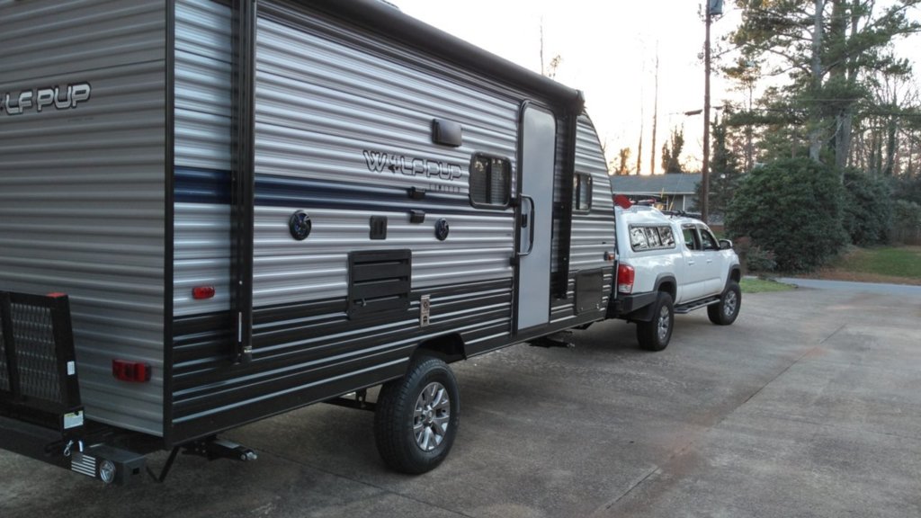

    Always tow with ECT on. I usually leave it in S gear, on 4. Sometimes I have to manually tell it to go into 3 for passing or onramps.
    Don't be afraid to floor it when towing. The truck will take it just fine. I use the full skinny pedal on uphill onramps regularly.
    Follow more often than the factory recommendation for changing your transmission fluid, towing is really hard on the torque converter and the Taco runs the transmission fluid in there hot. I'd even consider adding an aftermarket cooler if you're doing it often - that's on my todo list.
    My Taco's around 6klbs loaded from all my armor and gear, then I tow this:
    I use sumosprings to keep it level instead of a weight distributing hitch, which works great. The trailer is Forest River Wolf Pup 16bhs, but I've done a lift, upgraded the tires, and added a bit of weight inside redoing cabinetry and the bunks. I'd guess it's around 4k lbs loaded, so my total weight is around 10k lbs.

    Your truck is 6k lbs before tongue weight? You're not concerned you're like 1k lbs over GVWR...?

    Yes, just about. It's a DCLB. Add plate front bumper, winch, plate rear bumper, IFS skid, mid skid, tcase skid, gas tank skid, hi-rise camper top, windoors and rear door, camping platform, 2 roof racks, fridge, camping gear, recovery gear, omg it just adds up. My suspension's all updated to take the weight.
    I'm not at all concerned. It's a truck, and I use it as such. I offroad a lot so I need a smaller truck, but I tow a lot so I needed something large. The Taco checks all the boxes.
    Anyways, it's paid off and 50k miles strong, so zero worries. She's still getting broken in as far as I'm concerned. I look forward to it being my son's first truck in 9 years.

    Transmission was in S4, ECT mode on. I *highly* recommend a weight-distributing hitch. You need to even out your stance, otherwise your nose will be too high and steering and braking will be compromised. Plus it moves more weight to the front axle, thus lessening the strain on the rear axle. On the really steep grades (10% in western WY) I was in 1st and 2nd getting down to 15-20 mph to make it up the hill. Coming down the other side was a workout for the brakes (and that was with the transmission put into 2nd gear). If towing over very steep grades, I recommend upgrading the front disks (I didn't, but in hindsight I wish I had thought of it) to drilled and slotted rotors to help dissipate heat. I never had any issues on any other mountain grades (including long stretches of 6-7%) until that one 10% grade.
