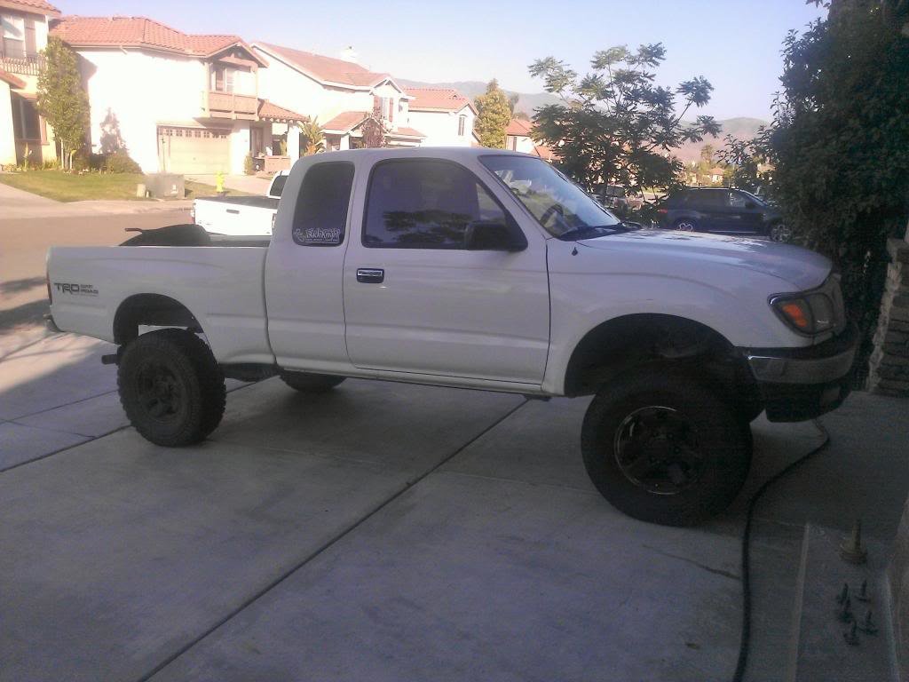

    I have a 3 inch lift and run 31's and have no rubbing issues what so ever, only decent pic I have

    Is there any way i can go 32s with maybe 2 inches, and trimming some?

    I dont see why not, but I would get a few more replies to that as im not too knowledgeable on that

    You should be able to run a 265/75/16 on 2 inches of lift
    You may want to trim a bit of the black plastic wheel well liner and hammer down the pinch weld seam
