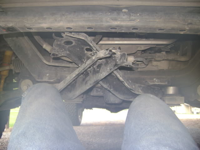

    I wanted to remove my sway bar. First I dissconnect them at their 2 outer most points. (17mm) I used a socket to break them then you need an allen to hold backup and a wrench to remove. I could only find my 5.5mm allen. It worked fine.
    Once that was done I couldn't find a way that satisfied me to zip tie it up safely. So I removed the skid plate Front is 12mm rear is 13mm I have the bolts from Toytec's drop kit. Then tried to wrestle the sway bar out. Got fed up and losened the brackets that hold the skid plate.
    Once loosened I moved them to the center to make and X

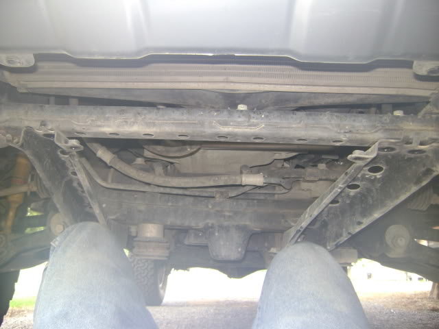

    Then the sway bar came out. Instead of reinstalling the bolts and skid I removed everything and placed aside. This is just to see if it is something I would want to do. If I like the ride I'll put it all back together without the sway bar. I'll report on ride quality later today.
