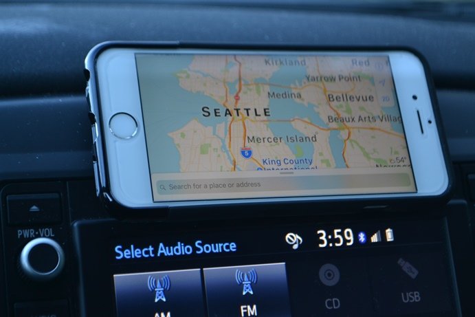

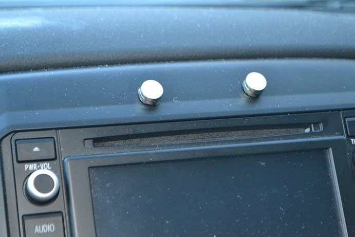

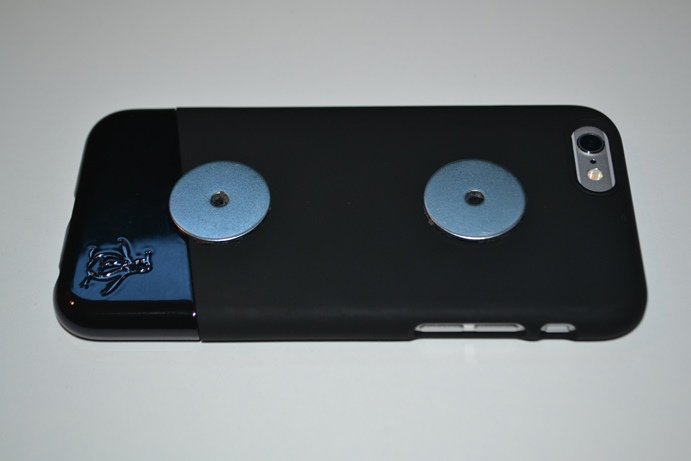

    dash--adhesive tape--2 magnets ///// washer--adhesive tape--cell phone case
    All materials were purchased from Home Depot.
    *Super Magnets 0.47 inch D
    *Fender Washers 1/8 x 1 inch
    *Scotch adhesive tape, 30 lbs load capacity, 1 inch W
    Note 1 When you secure the magnets, push them directly onto the dash board. Do not secure the magnets via cell phone (case).
    Note 2 I do not know how this setting is secure under extreme temperature.
