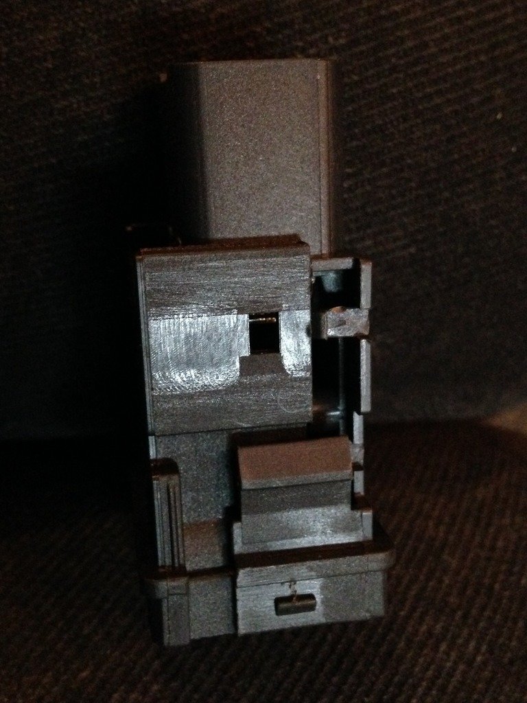

    A bit of FYI but the switch cover including the roller is made of translucent white plastic so a bit of Dremel work will allow the indicator on the roller(s) to light up as well.

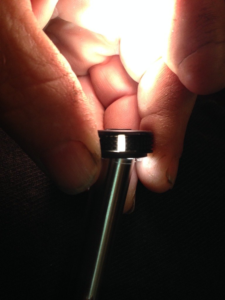

    Here's the inside of the roller with the black Dremeled off inside at the white line
    3BFFA3AD-01A2-4864-A34B-F58CA7BE4FD3_zps_7d090324c764679f5456ad85db6e4701caf63b4b.jpg And here with a flashlight illuminating it. 1E70F6D4-E856-44AF-AF2B-C15A13D9B2D5_zps_69f43227e32e12cae163a65b5d56ba7b1864e220.jpg

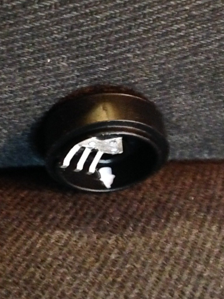

    The release tabs are visible on each side. Once the front cover is off the top separates from the bottom with a bit of careful prying after releasing the tabs. Just don't shove anything way in there to pry it open, there's a printed circuit board inside. Here's a pic of it partly separated, you can see the tab on this side and the "window" it snaps into.72742E27-E383-4CA2-9F3F-1D0345A41E90_zps_2ae964354f278bbb1d8327098d4f5ed1e91ce93f.jpg

    Thanks - I got the broken switch working again after opening it up and prying the contact fingers up a little inside the dial. Although I did manage to break the release tabs off that hold it all together. But it seems to stay together just fine without them. Used wrap of electrical tape to be sure.

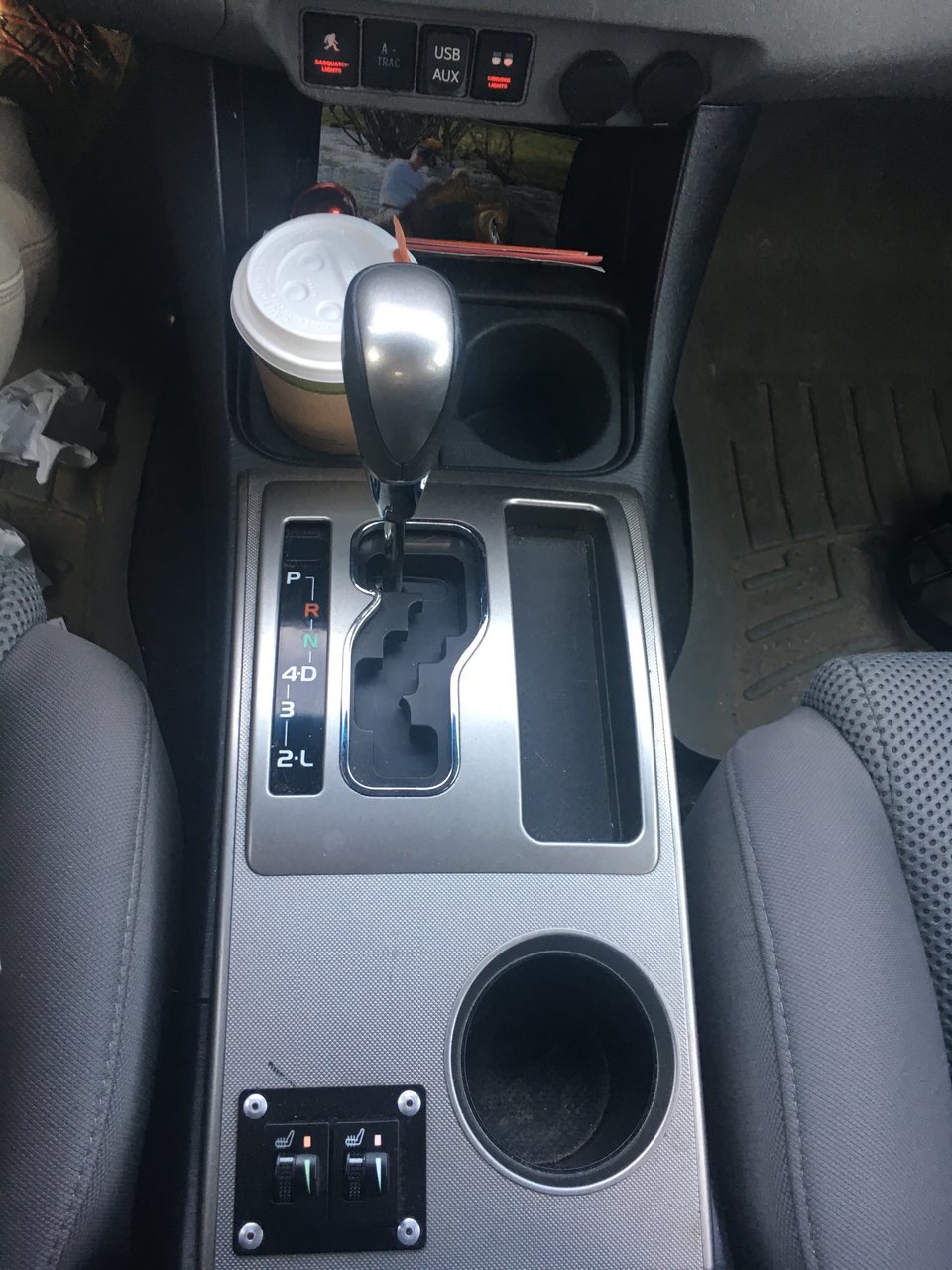

    I had one of my switches short out, due to power feed using a 30amp fuse; so swapped to 20amp per instructions (my mistake). The good news, I was able to purchase a replacement switch via EBay for $20 (vendor provided special link).
    https://www.ebay.com/itm/Seat-heate...ks-used-for-replace-the-damaged-/161452994568
    Due to no spare switch slots, I installed the my heater switches on the side console near cup holder, felt this was a more logical location, used a nice onboard air switch bezel (metal), dremmeled slots, riveted in place....Easy trick installation.
    Use the 2900 Series switch bezel for Toyota switches, linked here:
    https://www.aironboard.com/online/switch-panel-2900-universal-2p-push-switch-panel.html
