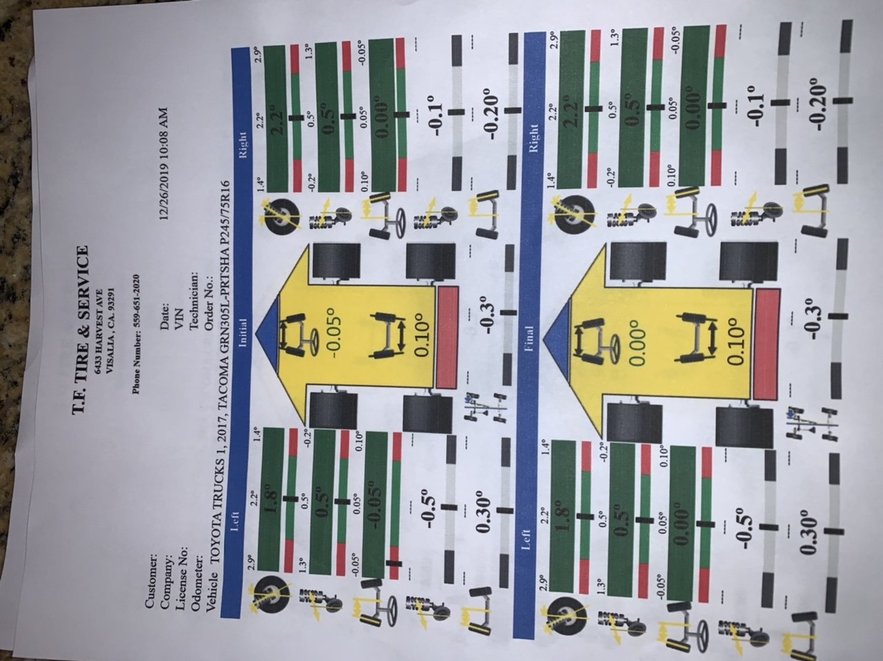

    Do these numbers look right to y’all? Truck drives straight but at 70-75 mph it has a vibration and is more noticeable when I slightly steer to the passenger side, almost as if there’s resistance or something. I can feel it in the steering wheel and I’ve already had the ECGS swap. Any thoughts?

    I never go by those readings - mine has been to the dealer twice since purchase in August for alignment and my steering wheel is still cocked slightly left. The service writers love showing you those GREEN readings - which mean nothing if the truck doesn't track straight.
    I think these dealer mechanics are poorly trained - not all but many. Their instructors teach them to get these things green, and they're done.... There's no test driving to verify the truck is going straight. I took a bunch of auto classes so I'm pretty familiar with the alignment racks and how they work.

    Caster is pulling the truck to the left, so your steering will be tugging to the right.
    It's hard to balance caster with a lift, these numbers arent terrible.

    As others have said, if you're lifted then being "green" isn't the correct numbers. Assuming you're lifted, your caster should be 3*-4* (closer to 4* the better). Do you have aftermarket UCA? If not, I would suggest getting some. I really like the SPCs because then everything is adjustable, but there are many good ones out there.

    Yes I’m lifted 3” with SPC UCA set at the 2 deg caster

    I'd push that to the 4* caster. They say 3* will get you back to stock, I always like it a little more. The tire shop that I have do my alignment are very proficient adjusting these arms and they do the same.
