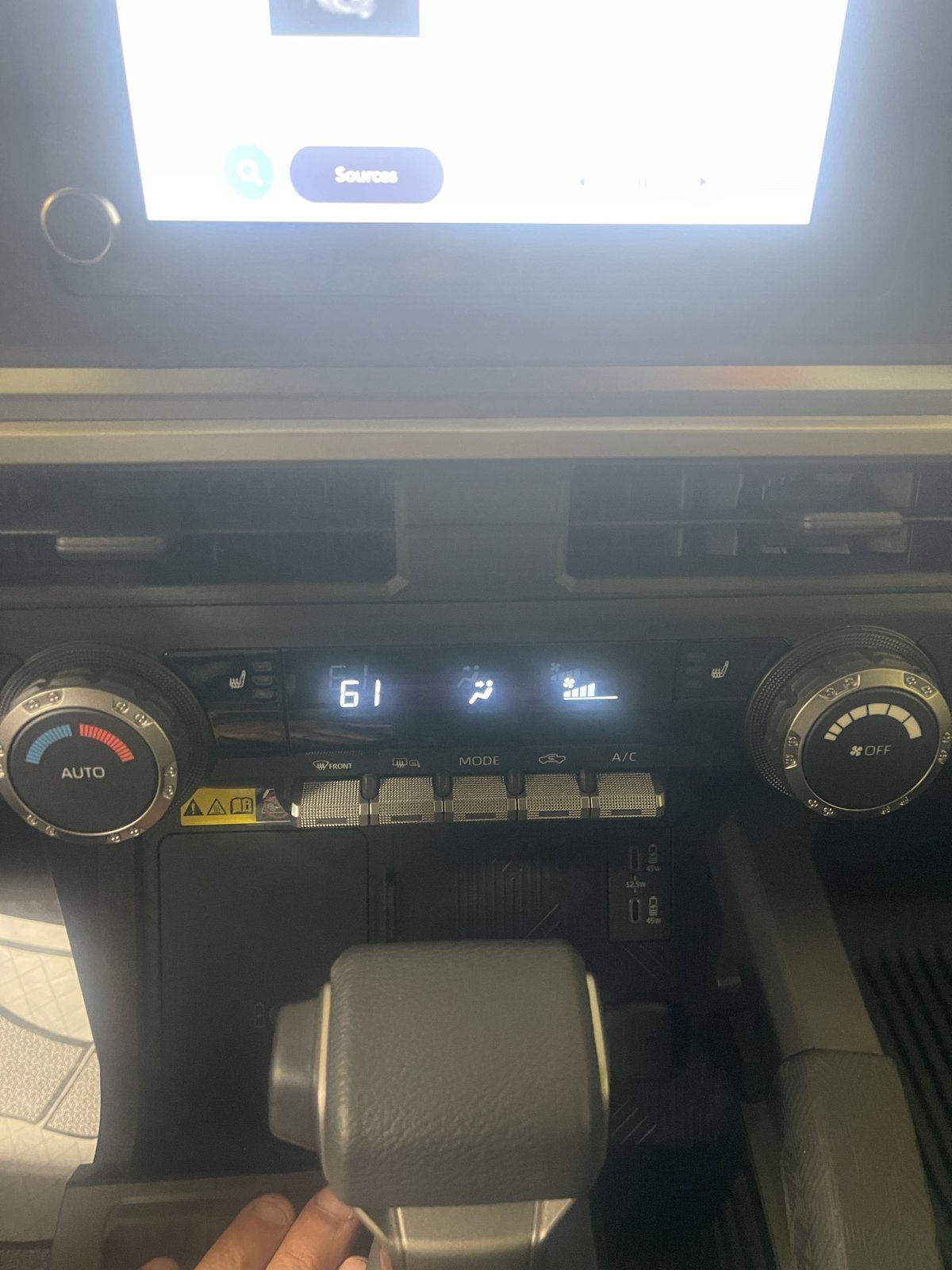

    Just confirmed that what a few of us are discussing, the AC system blowing ice cubes when in fact, the AC button isn’t on….
    I just confirmed in fact the AC compressor clutch field & pulley is engaged & compressor is turning.
    Which explains why it’s so cold with the AC off, big question is, why…

    So I just went to the truck to assess everything again.
    I verified that defroster is off and it was definitely not on auto mode.
    If auto is on it actually displays across the Digital cluster.
    Air just coming out the front vents and defroster off, set at 60.
    Compressor cycling and electric engine cooling fan on which fan always comes on when Air Conditioner is functioning on all vehicle as thats normal protocol / characteristic of vehicles with electric engine cooling fans.
    When a customer comes-in with an overheat I always turn the ac on to verify proper cooling fan operation.
    I’m sure it’s still normal, but not sure why it operates in this manner.
    I actually emailed the dealer shop foreman with a description, my thoughts, etc, see if he gets back to me...
