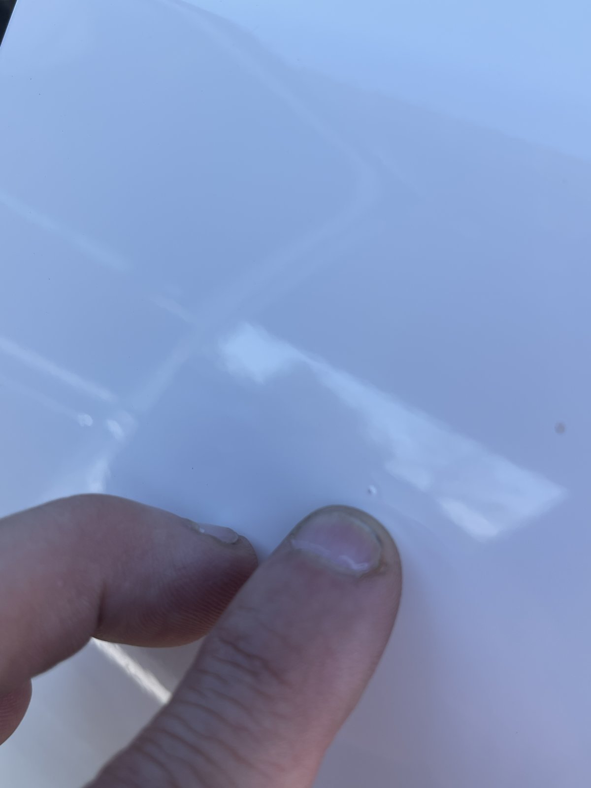

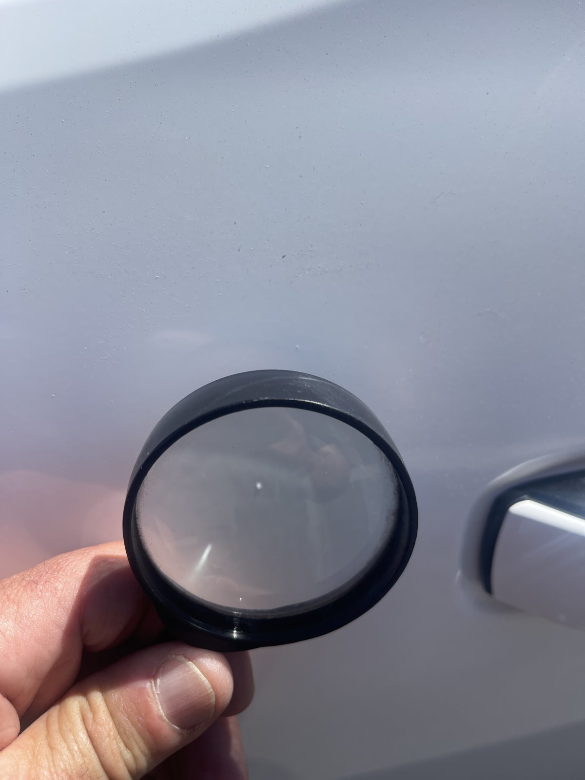

    its debris within the paint...
    I dont have a pic of the spot in question but heres a pic of 1 of the 6 spots they color sanded out....
    now im thread jacking...

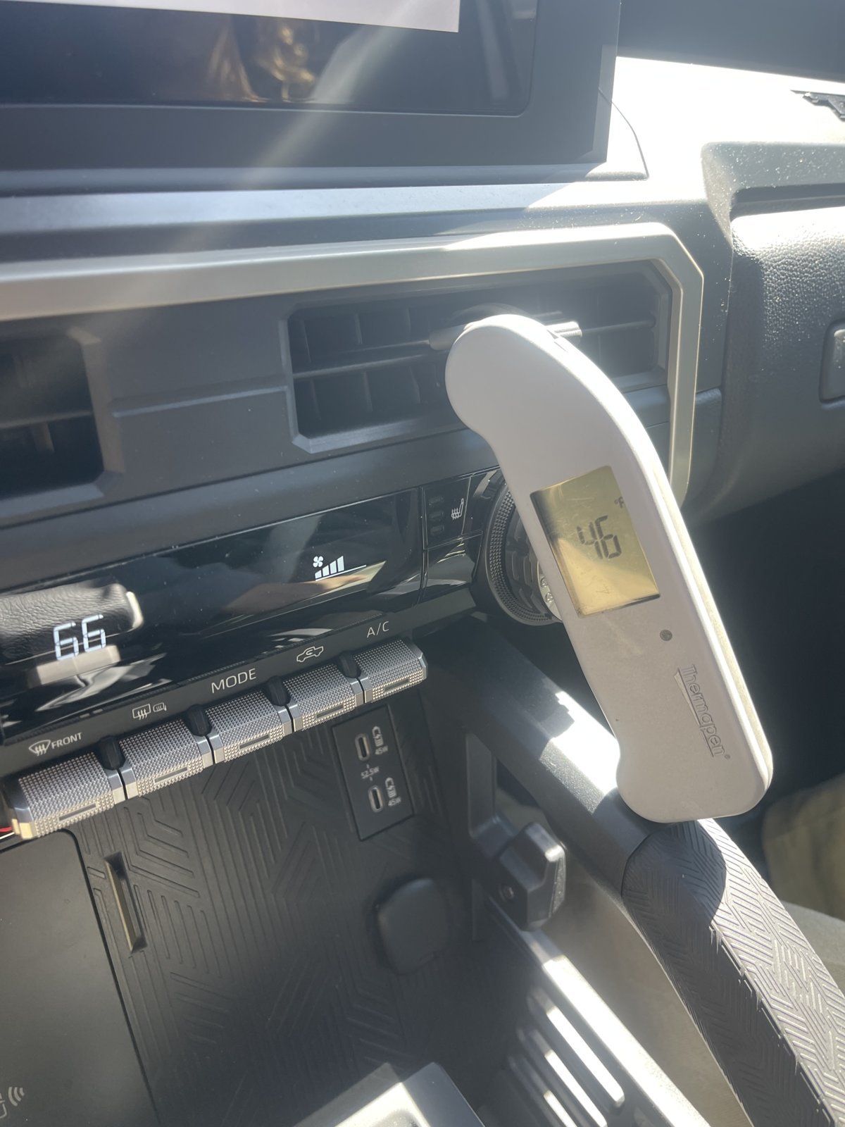

    IMG_4124.jpg So I had my ac checked-out twice & dealer is saying normal characteristic of vehicle, which may be the case....
    But getting contradicting info here along with me jumping in / comparing an in-stock but didnt drive it...
    The instock unit didnt blow cold in vent mode, nor did the ac compressor cycle & the engine cooling fan didnt run when I ran it on the lost for 3 minutes I check it out....
    Its documented as such at the lat visit:
    "the ac / climate control system is operating normally. Contacted FTS & confirmed the ac will run even if the ac button is not in the on position or if the defroster is also not in the on position.
    The ac system will work to dehumidify the cab by running the ac even if the switch is not turned on"
    I can only assume they know what im referring to.
    My system isnt periodically turning the ac on....
    The hi today was 76 degrees, I had the vents on, dial set at 66, defroster ac auto all off, blowing out the front registers at 46 degrees, cold air....
    ac compressor cycling, engine cooling fan on, it was like that the ENTIRE time I drove the vehicle, about 1.5 hours, multiple stops....
