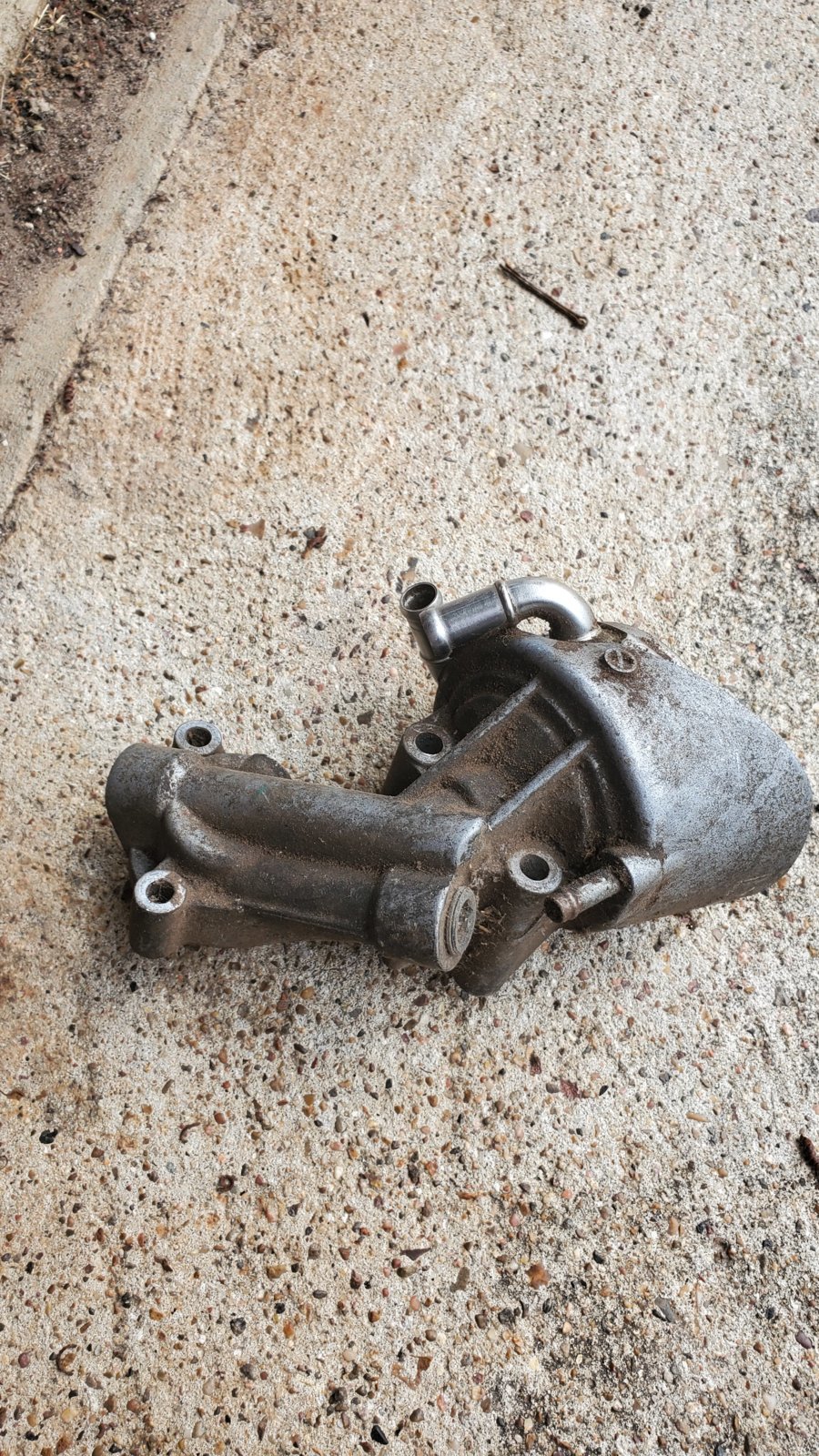

    It's the whole oil filter housing you would have to remove, the cup isn't separate.
    This is just an old one I have laying around from an engine swap I did at the shop but that's what the assembly looks like.

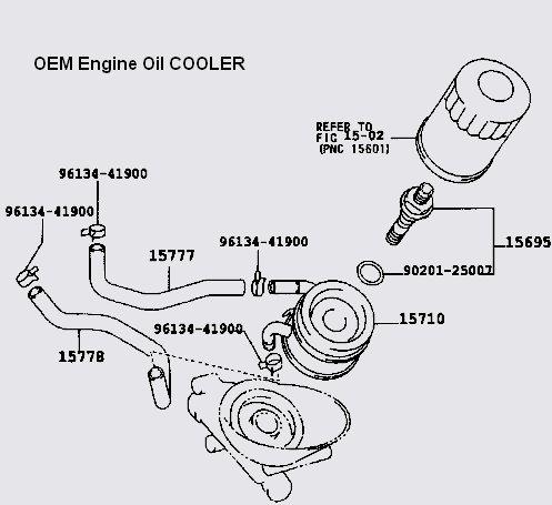

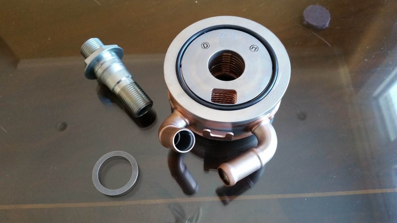

    If you have the tow package the engine oil cooler sits on top, it has coolant running through it.

    If the drip cup is in the way, can't you just take out the oil filter stud (24mm I think) and move it aside without disconnecting the coolant lines?
    The oil cooler seal might need replacing though..

    Heat exchangers operate using the same set of thermodynamic principles. Thermal energy is always conserved in heat exchangers. The direction of heat flow is always from the fluid with higher temperature to lower temperature.

    It's one of the components that boosts the tow rating on some Tacoma's to 6,500 lbs, so it's doing something. I would leave it alone. If you break or tweak it trying to move or remove it, it will cost you nearly as much as the entire Towing Package ($650) for just this one component to replace it, with possible risk of oil and coolant leaks while you are waiting for it to either come in or come off national back order.
    Give it a wide berth.
