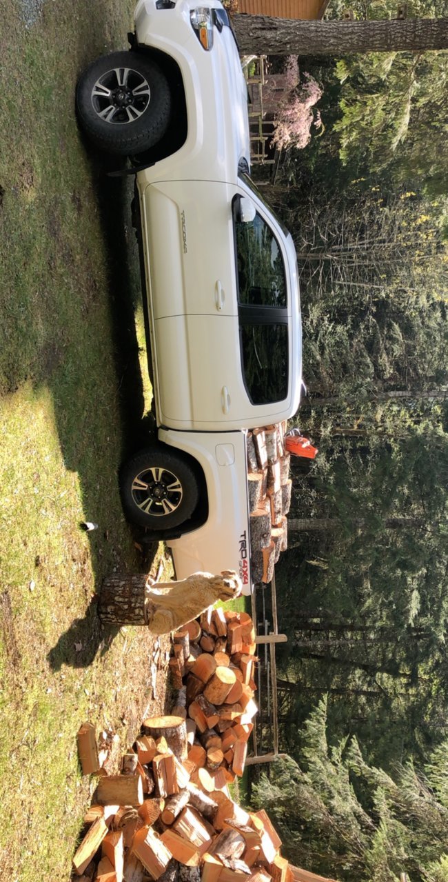

    I have 42k on it, and besides regular maintence nothing has gone wrong no issues. My only complaint is my leafs are pretty squashed, may have something to do with all the firewood I’ve gotten. Anyone have there leafs replaced through warranty ? BE7655D9-D29B-459E-8DA5-8F9F512085C3.jpg

    I tried to have the leaves replaced under warranty on my 2011 but it was a no go. 2 different dealerships insisted I prove I had never overloaded it. How do you prove that? I ended up having a friend at an independent shop replace them with after market "heavey duty" ones and was very happy with the results. The backend rise and front end nosedive during heavy braking that the truck had from day 1 was gone and it went from dropping almost 3 inches when hooking up my trailer to a little over an inch. The ride with and empty bed did get a little rougher, but switching to bilstein 5100's tamed that very well.
