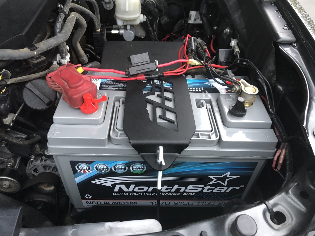

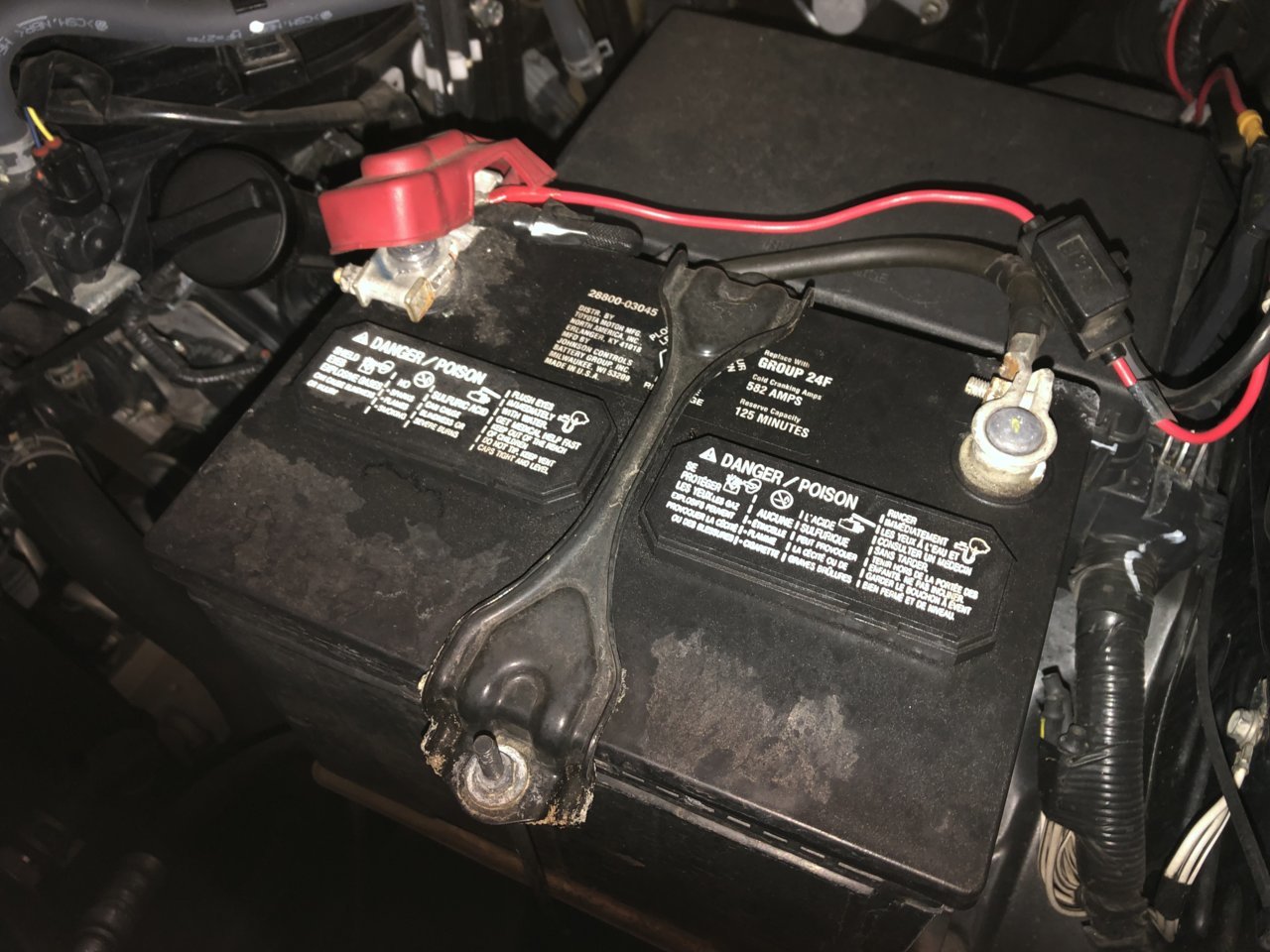

    My 2017 battery is shown below. Been off gassing and corroding for over a year and now having slow starting issues. Resting voltage is around 12.28 to 12.38 volts. Should be closer to 12.6. I bought the BatteriesPlus Northstar branded battery today and will be putting it tonight. I went stock size of 24F.
