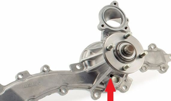

    On the 4.0, where is this weep hole?
    What brought this up was I was towing my camper and halfway to the destination in a 3 light town the truck started to overheat (like 3/4 up the guage, but not nearly in the red). I pulled over, waited a while and refilled with some distilled water and antifreeze, still not sure what happened. I squeezed and wiggled the upper rad hose to burp the air out (important point - because 30 miles up the road THWANK goes the upper hose - blew right off. So I pull over, repeat refill, and found the next store to put on a REAL clamp. Made rest of trip just being careful to hold back and time the few lights between my home and the campground (130 miles, 5000 lb hybrid camper). Even pulling up steep hills the temp stayed perfect, I knew it had to be the fan clutch. So all this is what has me considering if I should be replacing all hoses and thermostat soon. AFTER I take a cow to market tomorrow....hehehe......

    Weeps holes are towards the bottom of water pumps. Some have a 2nd weep hole on top to help to serve as a vent and stabalize the seals to atmospheric pressure. It can be normal for some coolant to seep out, but if coolant continuously seeps out, then it's an indication the seal has ruptured/torn.
    https://www.flowkoolerwaterpumps.com/info/common_waterpump_failures.html
