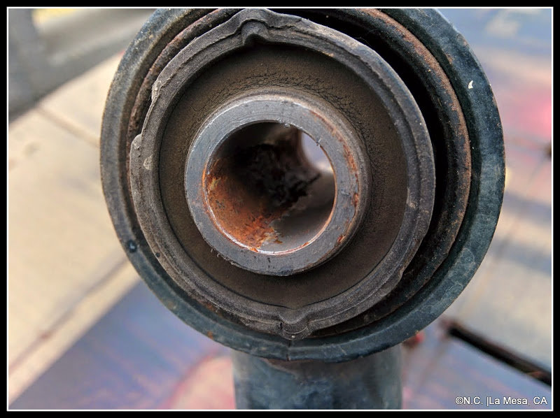

  13. Jul 12, 2016 at 11:37 AM
    Crom
    Crom Super-Deluxe Member
    Jun 22, 2009
    #18782
    9,648
    Nick
    San Diego, CA
    2009 4x4 DCSB Camp Supreme
    Millions
    This is a picture of my factory UCA that came off at 55K miles.
    It was daily driven mostly, with lots off off-road for a normal stock Tacoma at the time.
    Bushing has no tears and is intact and looks okay. But as you can see, inside the bushing sleeve, there is rust cancer forming.
    If you ever see this on your vehicle, clean and grease inside the bushing sleeve, and UCA bolt.
