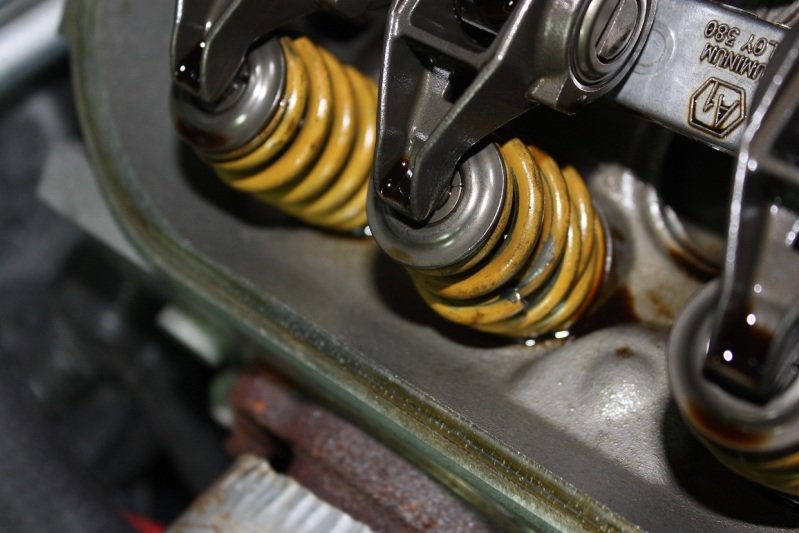

    it most definately does. ask any spring company about cold springs. i didn't say anything about going balls to the wall, i said 4000rpm. you guys are putting words in my mouth.

    LS6 rev limitor is 6600rpm, LS7 is 7000, my lightly modded LS1 is 6800.
    only the Z06 uses the yellow springs...maybe ls2s but they dont have hollow valves
    I know I am talking about the springs. They are the yellow springs. I have personally broken one and a PAC 1518 spring.
    look up z06 broken valve spring : http://www.google.com/search?q=z06+broken+valve+spring&sourceid=ie7&rls=com.microsoft:en-us:IE-SearchBox&ie=&oe==
    tons of instances. this is getting blow up way more than i intended.
    edit: broke_26b523cc8992d69a55c44ec2d441c54f04bb4556.jpg
    dont want to shit on this thread.
